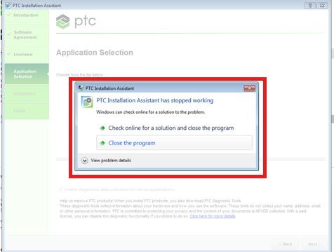

Error "PTC Installation Assistant has stopped working" when running setup.exe for Mathcad Prime".
Harry_Seth
Error "PTC Installation Assistant has stopped working" when running setup.exe for Mathcad Prime" (Applicable only for SUA Edition)
 Cause:
  1. Microsoft for .Net Framework is missing or is not installed correctly
  2. Microsoft Visual C++ 2008 SP1 is not installed correctly

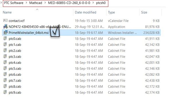

Resolution:
  • Run PrimeWixinstaller_64bit.msi from the ptcsh0 folder of installer 9.3.jpg
  • Run the fix provided by Microsoft for .Net Framework 4.5.1
  • Try to uninstall and re-install Microsoft Visual C++ 2008 SP1 Redistributable Package:
    1. 32 bit
    2. 64 bit
