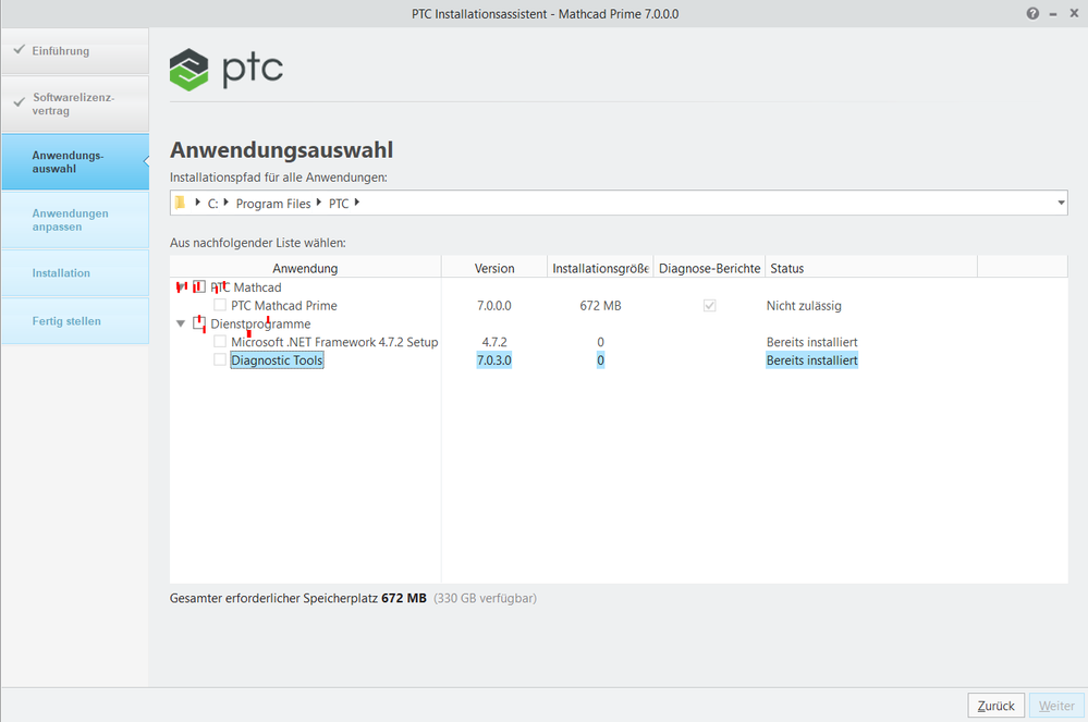

I can not install MathCadPrime Version 7, but I need it to exchange data with my colleagues. This is not about the trial edition. It is about the real edition of MathCadPrime 7. The failure message is: "Nicht zulässig".

You possibly already have Prime 8 or 9 installed on your PC.
You cannot install Prime x when Prime x+N (where N>0) is installed. You have to install Prime versions in ascending order.
If this is your case, you could remove the higher versions from your PC and install 7, then 8 and/or 9.

Please show a screenshot of the error you are experiencing.
Please find attached a screenshot of the error.

How could I add or attach a screen shot to the post?
