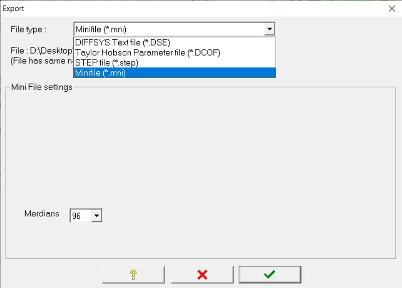

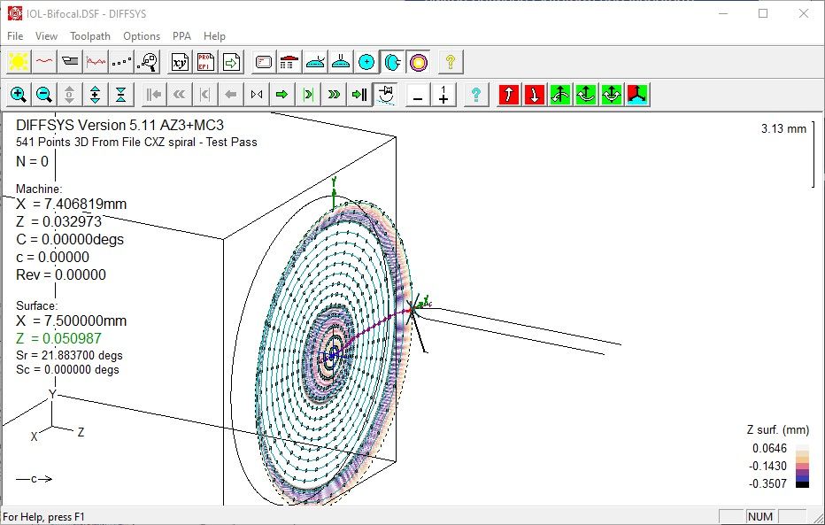

2. And a software that export a ready mini file for Optoform: https://www.precitech.com/product/diffsys/for-ophthalmic
minifile-3d-window
export-minifile-window
Thanks, Vladimir! Very helpful! Between Yor answer and Luc's, I think I know what's going on!
