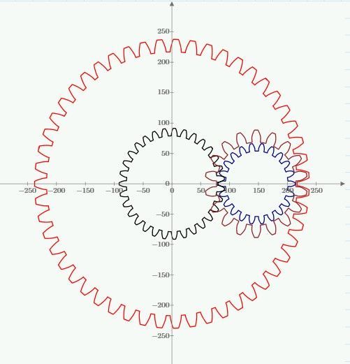

Solutions so far have covered the topic excellently, so thought I would expand.
Drawing of optimum configuration of Sun, Planetary, and Ring gears.
Have yet to draw the other planetary gears but time is running out.

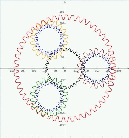

April 1, 2022
Know its late.
To position gears P2 and P3 in the system need to track the epicycloid and center of P2/P3 rolling around the sun gear.
