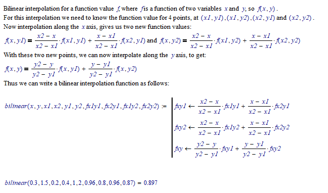

See if this helps:
Here is another method that means all you need is enter the two search values to get an answer.
I would improve this by programming the individual steps but have left it so you can see intermediate values.

One more way:
