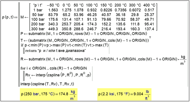

One more way:
ValeryOchkov
(To:DJF)
My old solution
