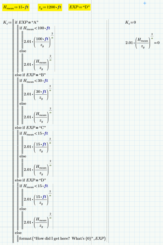

I have attached P9 mathcad sheet. I am struggling to do four "if" statements. I have  four different exposures A,B,C, and D. I managed to do up to exposure B. I just did exposure "B" and I don't remember how i did it.I am not able to add another "else" statement for exposure C, D.

The programming construct elseif might be what you're looking for.  Is the following what you intended?

The issue was  i did not have the double line "Program" as you are showing before i started my if statement. I corrected it and got the result.
