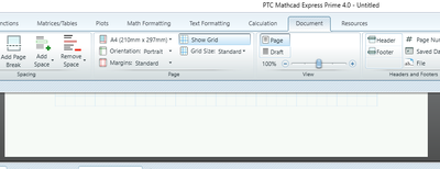

Here's Prime 4 express with the banner exposed:

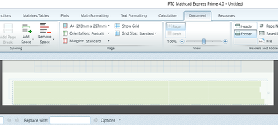

as well as hidden in the footer:
skunks
(To:LucMeekes)
🤔 what happens during PDF export?

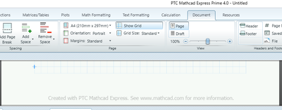

LucMeekes
(To:skunks)
Point taken.
But with a text box filled with spaces it works, if you set the text properties to a coloured background (I used light green here, can also be white):
in pdf:
