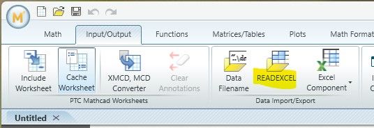

You can use READEXCEL and WRITEEXCEL simple functions to exchange data with EXCEL rather than the more cumbersome API coding.
Look them up in help.  You can use a helper wizard on the menu ribbon to use READEXCEL..  Input/Output | Data Import/Export | ReadExcel.
