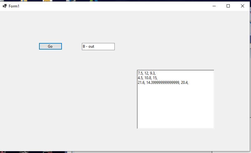

The following code "Inputs" into Prime worksheet a 3 x 3 matrix.
Prime multiplies the matrix by three.
Prime "Outputs" the now larger matrix to the calling program and displays it in a rich text box.
The program works by hitting a go button.
It is programmed in Visual Studio 2019 in C#.
The actual code is as below.
I have enclosed a zip file with the mathcad sheet and the visual studio solution.
The file worksheet name is hard coded

Thank you!
I used this part
hereResult.MatrixResult.GetMatrixElement(ic, jc, out dblhere);
and it works!
