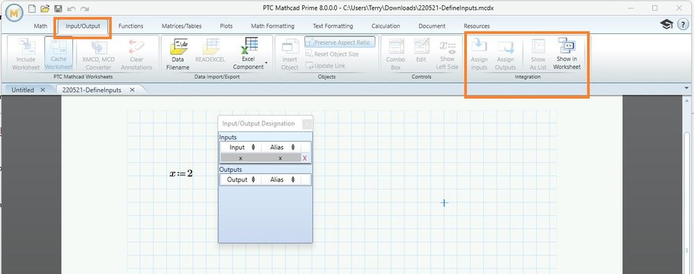

I'm still learning how to use API for Mathcad and I have a few questions about this function, SetRealValue.
1) why doesn't the code below work? I mean there are obviously no error, but it doesn't do what I want. In the selected worksheet has x:=2, I was trying to get this x:=2 to be x:=3m. This code below doesn't change anything in this sheet.

Asked to see the worksheet to see if input or output had been assigned.
To change the value of an item and its units in VBA/Prime value needs to be set as an Input parameter in the worksheet.
Highlight x:=2
Assign Input will no longer be greyed out.
Press it and a small blue box with "in" title will be visible every time you highlight x=2.
Use Show as list button to show the defined inputs and outputs.

So, I highlighted, hit "Assign Inputs". Ran the script above again and nothing change, still.
I can't access the attached file though, only have up to Prime7.0 Sorry
Will do something up in Prime 7 give me some time.

Happy to see 1) and 3) solved.
If you have more than one input defined for "x" the alias that you can use to differentiate between them will automatically be different.
