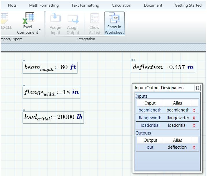

In Prime  there is an additional step to pass variables to and from the API.
On the Prime window ribbon menu "Input/Output | Integration | Assign Inputs" where exchange variables are identified.
Refer to the help which is where the image came from.
Cheers Terry

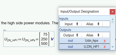

I made the calculations to "Output", but still the transfer does not work.
Even when "varname" matches exactly the Alias of the Output, I won't get a value transfered.
WertEinlesenMCAD.uwrk = mcws.InputGetValue(varname).GetMatrixElement(0, 0)

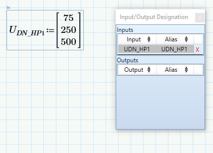

The terminology is a little difficult.
Use input for getvalue!
It is Input to API and output from the API?
As per the example supplied no dot in the alias.
Cheers
