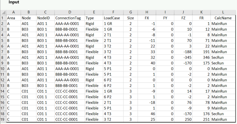

I have a new question for you that should be straightforward. I'm wondering how write a program to add additional rows to a matrix, where the values of the elements are calculated according to a formula using existing data within the matrix.
The attached Excel file includes a tab with input for the ReadExcel function, as well as a tab showing the desired output by a writexcel function. Essentially, the matrix is a list of node point IDs with force vectors due to six load cases. Each node ID will have the same number of load cases and the input will be always sorted by LoadCase column. I would like to add new rows for each node ID, namely 7 OPEPOS and 8 OPENEG, using a specific formula which pulls its input from the existing data within the matrix.
Input for the readexcel function:
Desired output by the writexcel function:

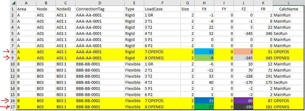

Rows 8, 9, 16 and 17 should be added by the formulas:
FR is the force resultant.

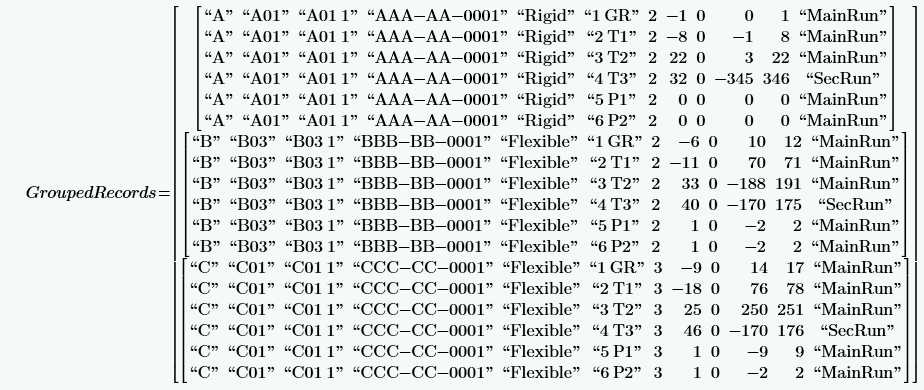

I started with the program as suggested and my Prime worksheet is attached as well as the raw excel data for the input.
Please disregard the previous excel input file and work with the attached excel file "Input and Desired Output v2.xlsx".
I was able to read the raw data and then sort the matrix in groups of NodeIDs.
I can take it from this:
To this:

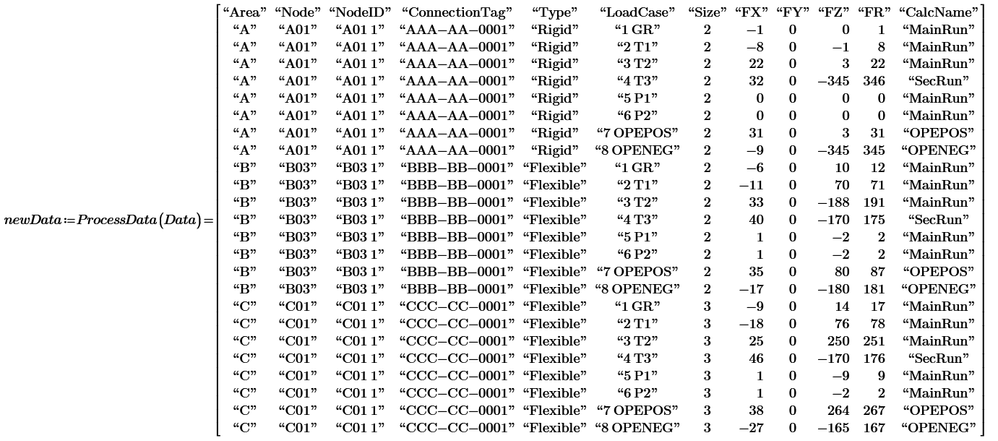

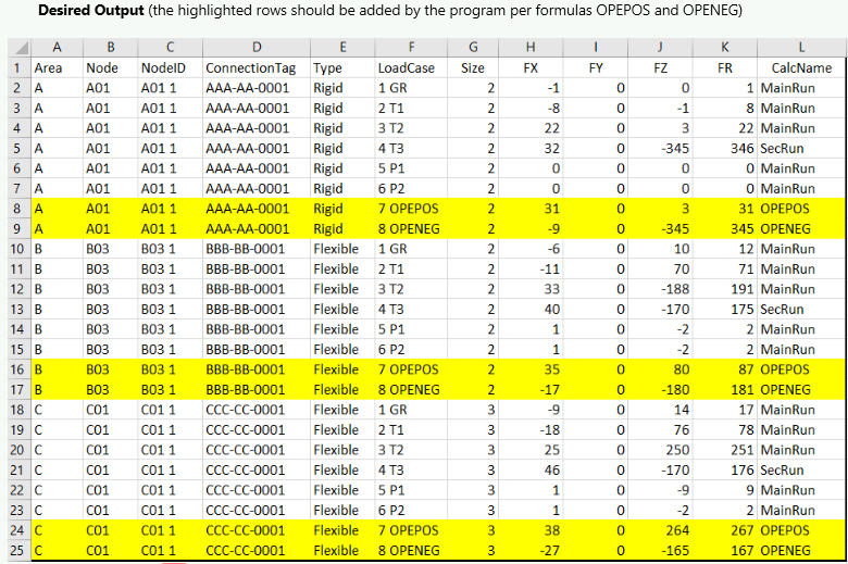

Where I need the help is to insert two rows for each group with the calculation of OPEPOS and OPENEG for FX, FY and FZ columns.
FR is the resultant force calculated by the square root of the squares (FX^2+FY^2+FZ^2)^1/2.
The desired output should be like this:
The formulas for OPEPOS and OPENEG are in the MathCAD worksheet so you don't need to type them from scratch.

Hello @Werner_E and @LucMeekes
The program worked.
I had to adjust the number of columns for the submatrix when reading the Input (from cols(Input)-1 to cols(Input) )and then I created the header and finally made the Data:=stack(header,data) before passing it to ProcessData(Data).
The newData matches the desired output. I also tested it by adding another group of nodes with the same six load cases. I will expand the program for more load cases that will be input for other formulas. If I run into some issues, I'll let you know.
