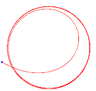

Again, here I am asking for help in animating a chart. I can't get a moving dot/symbol moving on the red curve. In particular, I am not able to successfully define the symbol and its movement parameters in the diagram.
Kind regards, Alfred Flasshaar
The attached file should help!
(To:Werner_E)
Here is a slight variation
(The predrawn red dotted path was partially 'deleted' by the conversion avi->gif. See the attached original avi for comparison.)
Thank you very much. Apparently I'm too clumsy with software. This illustrates the solution of a modeled tracking problem: "Monthly Notebooks for Mathematics", Volume 64, Issue 4, Page 305, 1959.

It's alIt's all a matter of experience and practice. The more you work with these animations, the better you will be able to handle them and realize how much you can do with just one automatically changing variable (FRAME).
