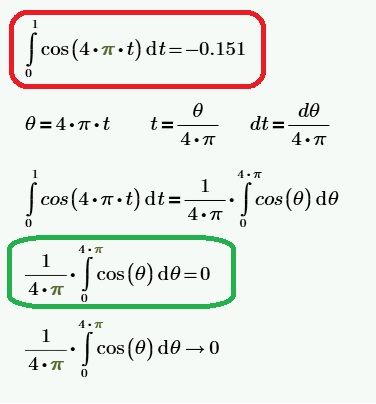

Hi Folks,
I just got Prime 7 and tried to do a sample calculation for a class.  It doesn't seem to be able to evaluate a very simple integral.  V15 and MATLAB both get the right answer with no problem.   The weird part is that it only gives the wrong answer when the number is 4.  I didn't see a problem with other numbers.  This was for a lesson on Fourier series.
Hopefully, the problem is me and not Prime 7.  I most appreciate any suggestions.
Mark
Bummer.  Opened case Case 15810622. Cannot trust numerical calculations?

I'm sorry, but the problem is not you, but Prime 7.
Better stick with Prime 6, where it was still OK:
Which means that PTC (again) managed to make things worse.

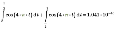

But it does get better in Prime 7 when you split the integral up:
And then it doesn't matter how you split it up:
If you're a licensed user, report this serious bug to PTC.
mfrench
(To:-MFra-)
Thanks for the example.  It appears to work as a symbolic calculation in Prime 7, but not a numerical one?

Another oddity:
mfrench
(To:-MFra-)
This is interesting.  The lesson seems to be that there are ways around the problem, but you have to notice the problem and know the workarounds.
