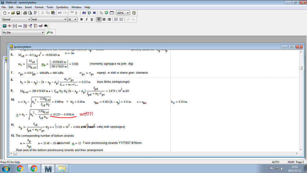

"i" ist not "appearing" instead of units but additionally. The value under the root is negative and so the result is a complex number, consisiting of a real and an imaginary part. "i" ist the imaginary unit.
If you did not expect that kind of result, you'll have to check the values involved.
