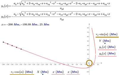

Five points are known - the coordinates of the asterod approaching the Earth. Will it face the Earth or fly by? (Armageddon (1998 film) ).
I have one solution, but I do not consider it the most optimal or the most beautiful. Can you give your solutions. Prime 5 in Attach.

Thanks, but NO!
We have 5 points not 2!
My solution. Do you have more interesting? more correct?
One question - rank1=4 rank2=4 cols=5!!!
Hyperbola, ellipse, ParabolaHyperbola, ellipse, ParabolaLsolveLsolvePlotPlot
To the question of the accuracy of the solution
