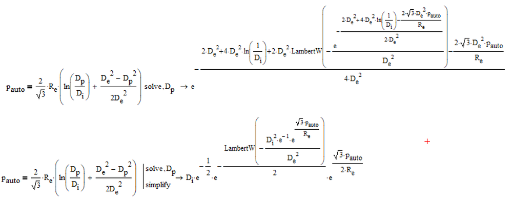

i have a Formula to calculate the elastic plastic transition diameter for autofrettage:
Dp is the elastic plastic diameter. The problem is i need to plement the calculation for DP into microsoft excel.
I need a formula to directly calculate DP. Now im using the solve function in excel but the solver is not trustable and does not give always a result where a result is calculateable.
Is there a way to transform the equation so that DP=..... for microsoft excel?
Transforming gives this block in Mathcad
where RE Yield Stress @20°C

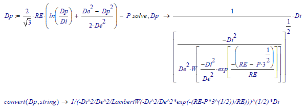

The function you found using mathcad uses the LambertW() function. Please find out first if Excel knows/supports that function.
The conversion to string should not be difficult. If you save your files as Mathcad 11, I can (try to) convert it to string just like:
But... As said: Your Excel needs to support the LambertW function, and I have my doubts about that...

I don't see Re cancel, You can divide it on P, to make life simpler. But you can do the same with 2/sqrt(3)...
Anyway, I put the equation in Mathcad 11, solved it and converted it to string:
And to save the tedious retyping here is the string:
1/(-Di^2/De^2/LambertW(-Di^2/De^2*exp(-(RE-P*3^(1/2))/RE)))^(1/2)*Di

In fact what we see seems to be the result of the infamous static symbolic solve - the second line being the first equation solved for D.p. I am still confused about the "c" we see in the picture at the end of the exponent fraction.
Better to use the dynamic symbolic solve and also let Mathcad simplify the result.
