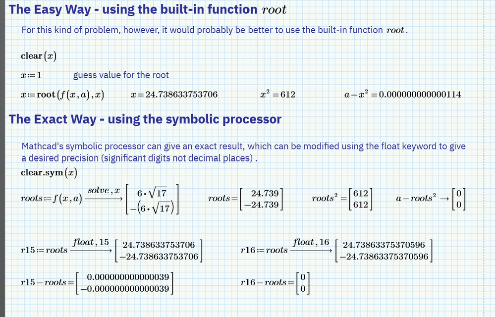

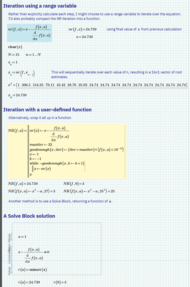

There are a multiplicity of methods of solving iterative problems within Mathcad.  Which one is best (for values of best) depends upon the nature of your problem.  Indeed, there may well be non-iterative solutions to your problem.   Here's a starter ...

Of course, it could well be that none of these methods suits your problem.  If no methods are suitable within Mathcad Prime itself, it might be possible to use JScript within an Advanced Control or some external program that calls the Mathcad Prime API (there are plenty of examples within the Mathcad Prime Help; search for Automation or API).
