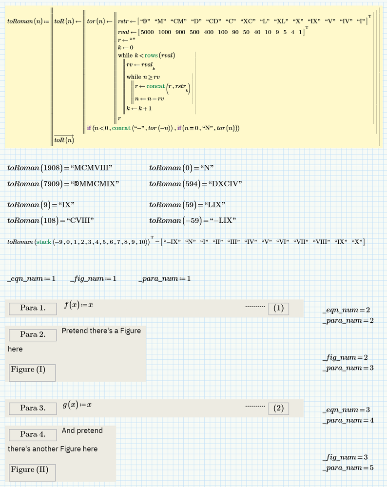

Are there plans for Mathcad Prime to include automatic paragraph, equation and figure numbering?
It's not ideal, but MP10's Advanced Controls allow a rudimentary form of entity numbering.
The topic has been broached several times since at least Mathcad 11.

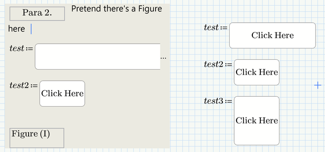

BTW, have you ever tried to create or copy a button in/into a text region?
StuartBruff
(To:Werner_E)
Just a moment, ....
Yes.  😁
It's interesting how you can paste certain things into placeholders, etc, but not insert/type them directly (yes, 3-place range operator, I'm looking at you!).
Stuart
(To:StuartBruff)
That's crazy!
I asked because I noticed that we cannot create an advanced control in a text region but we happily can create a Text Box outside and copy it there.
When I tried the same with a button I ended up with a button stretched infinitely horizontally - impossible to resize.
After seeing you reply here I tried again and it worked flawless. Not sure what was going on last time.
EDIT
Ahhhhh!!
I was able to reproduce the error!
Create a button outside of the text region and before you copy it, resize it horizontally. Then copy it to the text region.
As you can see in the picture, copying a button (test2) which was not resized experiences not this problem, but it looks like we can't resize controls once they are inserted in a text region.
This all smells like a very bad bug.
BTW, don't try to copy a button which was scaled vertically (test3). You have been warned!

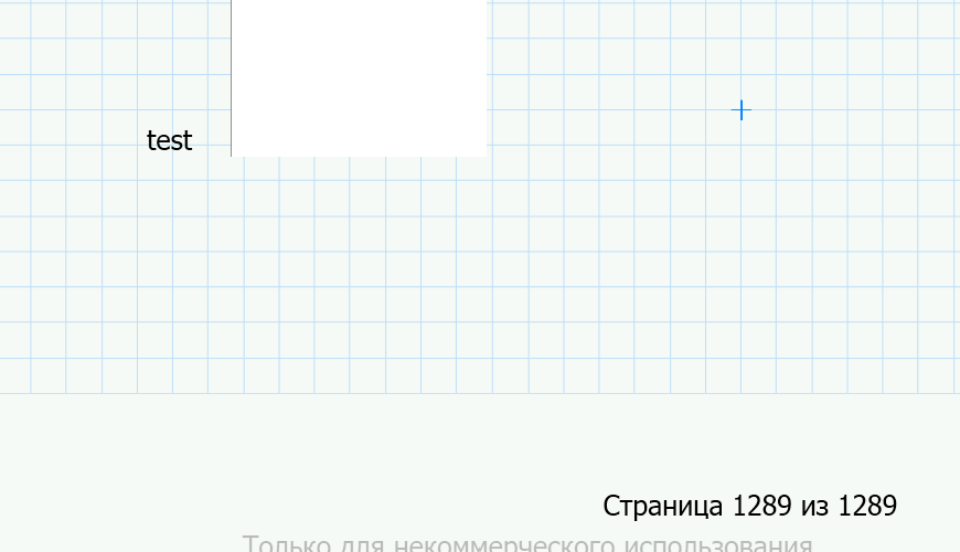

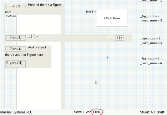

I also have to admit that I lied. The extent of the copied elements is not infinite.
Copying a button that was (also) slightly enlarged in the vertical direction results in a worksheet of 'only' 1160 pages.
On my last try using a fresh new worksheet it expanded to 1289 pages 🙂
Seems to depend of margin size, maybe also grid size selected.
StuartBruff
(To:Werner_E)
Snap! (in Russian)
That's with the default template, which has a grid so wide that I need to organise an expedition to go from one cell to the next and margins that make the Siberian Steppe seem small.
Stuart
(To:StuartBruff)
Reassuring, then it is a bug in the software after all and not an installation error on my part.
