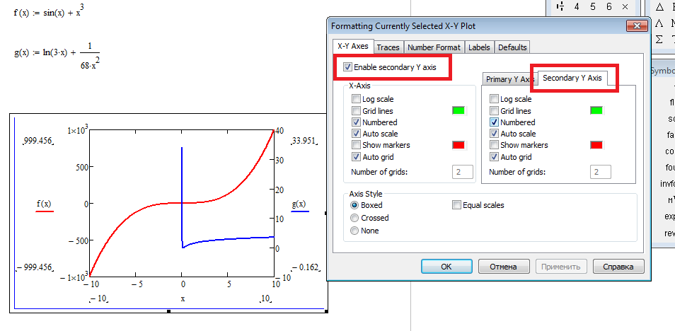

Simple one, does anyone know if it is possible to plot two datasets with vary different scales and display two different scales? i.e. have two differing y axis scales? You often see graphs with one scale to the left and one to the right each with their scale and units respectively. Wondering if MC can handle this?

Mathcad 15 can.
Prime (up to 4.0 at least) cannot

Mathcad 15 can.

Here is an example in Mathcad 15:
