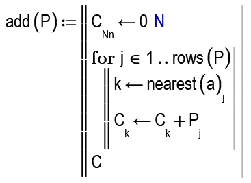

Hi All,
We have been using this worksheet for a while which in theory allow us to look at different restrain configurations. Its always been a bit flakey, but converting to Prime seems to have finally killed it.
I just wonder if anyone has some advice on how to get it to work?
(To:SM_6465178)
I stopped at the first error thrown
The error about unit mismatch is thrown because you can't add a dimensionless quantity (C) and a quantity with unit N*m/s^2 (P).
Prime isn't using SUC (static unit check) anymore and so its necessary to apply a unit even if the value is zero!
But even if we fix this, we get a similar error, This time because Load is a vector in N, but add(P) results in a vector in N*m/s^2.
Haven't look further as this sure has to be fixed first.
It may have worked in Mathcad because all involved values seem to be zero anyway. But you sure can't and shouldn't add quantities of different dimensions!

Of course the Load vector add(P) vector need to be in the same units, which are kN.

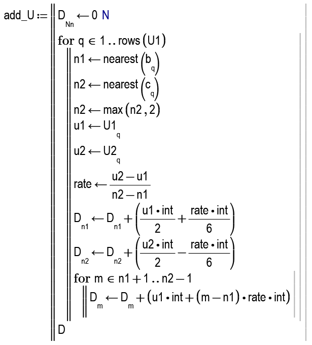

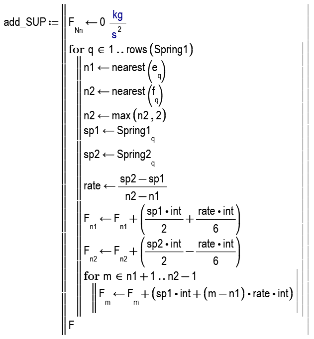

Thought you might like the latest version, I discovered that it only took some small additions
to allow the distributed loads and suppots to be trapezoidal, not just uniformly distributed.
Add 0 right units.
