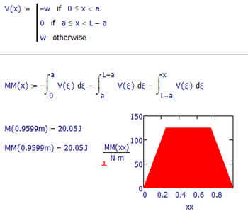

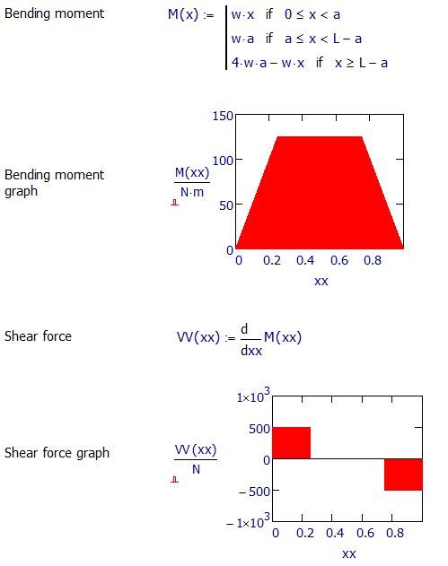

I have started drafting some material for student engineers relating to bending moments and shear forces. Initially,  the SF and BM were calculated long hand and the plotted graphs look correct. However, when integration and differentiation is used the graphs are not correct. I am using M15 with Windows 10.

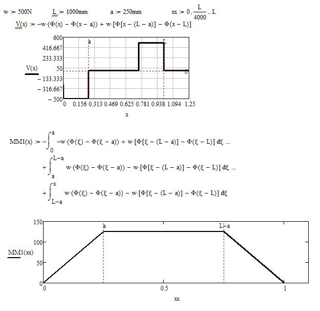

I broke the definite integral into three parts and the defect disappears, look here:

I have tried this and still get the same error. I have just modified the functions and swapped the 'otherwise' statements to 'if' as shown below:
This has corrected the differentiation error when plotting the shear force diagrams, but there is still an error with the bending moment (MM(x)) plot when integrating V(x).

Nice work and the graphs are look correct. However, it still isn't clear why the bending moment formula in my worksheet (MM(x)) is returning a zero value for MM(0.9599*m) and above.

Voilà:

That is a very clever workaround and something I have not seen before. I actually don’t think I have seen the Phi fuction (not sure if that’s the correct name) used ever.
Is the issue in my example due to a discontinuity in the shear force assessment?

2) No, its the splitting of the integral in three parts (which shouldn't be necessary) which does the trick. It works OK with the way you defined V(x), too. Have no idea whats going on an why the result suddenly is 0. Tweaking TOL did not change anything.
BTW, using the Heaviside function Phi makes the definition a bit less clear but has the advantage that you can evaluate a function defined that way symbolically, too, if necessary.

The behaviour of the integration suddenly going to zero is certainly strange, especially as differentiating the bending moment for shear force works.

Yes, and the Mathcad help only succinctly recommends to split the integration into parts which Francesco did and could make it work.
I tried decreasing TOL and/or changing the method of integration, but in vain.
BTW, you should replace the expression "4wa-wx" in your definition of the bending moment by "w*(L-x)" as otherwise it would yield wrong results if you change "a" from 0.25m to some other value.

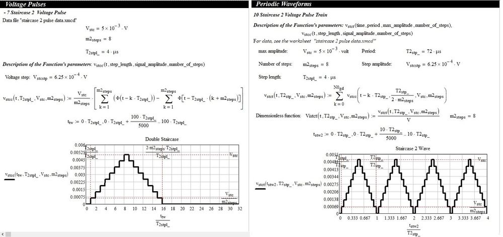

F(x) is a special function often called Heaviside step function or simply unitary step. Its derivative is the Dirac pulse.  For example, you can plot functions like the one here depicted:
