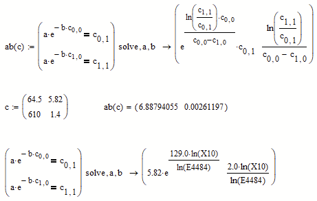

BTW, does anyone know, why Primes symbolic can't solve this simple system of equations?
The new symbolic in Prime 6 claims that no solution was found and the legacy one (muPad) runs quite long and then we see
A similar useless result in MC15 which uses MuPad, too.
The system can be easily solved by hand and we get
Guess MC11 with Maple under the hood for symbolic does not show that problem of not being able to solve this system.

Challenge accepted, Mathcad 11/Maple finds an exact solution:
And if you want the numerical results:
(To:LucMeekes)
I didn't doubt that MC11 would be able to solve the system.
The interesting part is that MC15 can do likewise!
Its only until you feed numbers in first place that the system can't be solved:
How does MC11 handle this?

That's in line with my philosophy:
If you want to work symbolically, then use symbols as much as possible. Once you have a symbolic solution you can fill in numbers, to get a numeric answer.
As a matter of fact, I didn't even try to use the numbers with the symbolics, until now:
The error message is "Unknown error"... 😶
