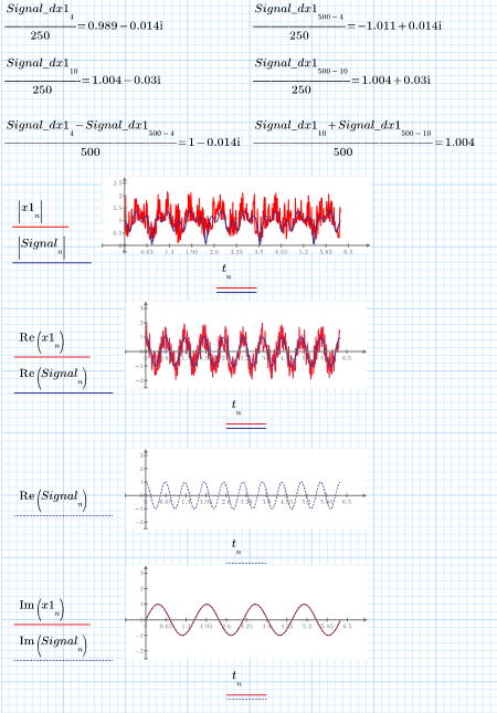

ttokoro
(To:JXBWk)
image.pngimage.png You can get true magnitudes(=1) for both cos and sin waves.
