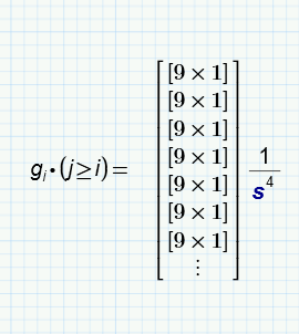

Calculated matrix element showing [9x1] instead of a value
YL_9713387
8-Gravel
What does this [9x1] matrix element imply, and how do I change it to numerical results? Thank you for your help.
LucMeekes
(To:YL_9713387)
It means that the elements of your vector are vectors, That is, you have a 'nested matrix'.
Check under the Matrix tab to display nested matrices: uncheck 'collapse nested matrices'..
But I think you did not want a nested matrix. Somehere in your calculations the result is a vector, where you expected a scalar.
Attach your worksheet so we may be able to help find out where.
