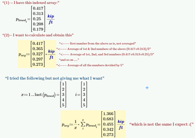

I have an array, and I need to create another array, and calculate the successive average of the numbers as I move along the first array.
For instance, the average of 1st & 2nd, then the average of 1st,2nd, and 3rd, etc. till end of the array
Below some more explanation, including my attempt, but I could not reach what I am looking for. I appreciate your help... Thanks

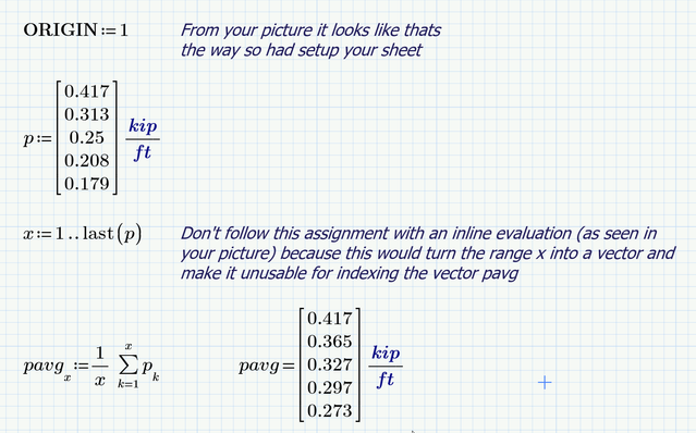

Here are my 2 Cents.
I can't read Prime 7 files and was working from the picture you posted.
I tried to provide a solution as close as possible to the attempt you made.

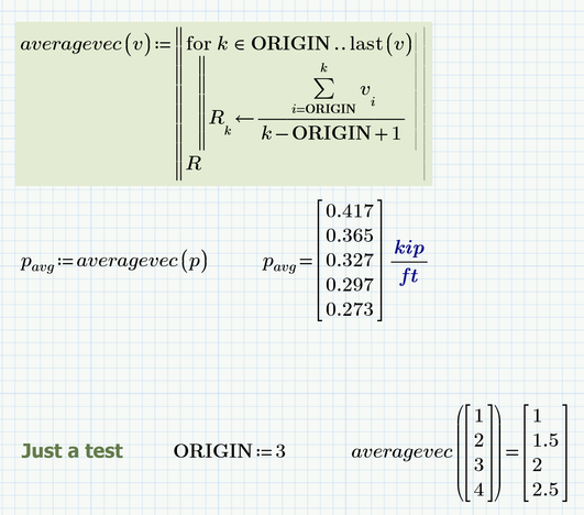

Nonetheless, personally I would prefer a userwritten uitility function with no need for any range variables defines on worksheet level and which is also independent from the setting of ORIGIN:
Prime 6 worksheet attached

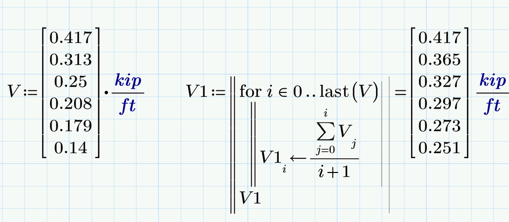

Send please the sheet.
Thanks @ValeryOchkov .. attached is the file
Thanks @ValeryOchkov, but this still give me an error, when I try it with the file that I sent...

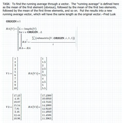

Here is my approach using MCP 5.0.  I set ORIGIN to 1 to simplify the division of [running sum]/[running count] = running average.  I tried it inside the program, but the global setting in the Calculation menu seemed to defeat it, so it goes (for now at least) outside the program.  And, as best I can tell, the last step is required to get the complete vector of solutions.  Without it, I get just the last average.  A better programmer might be able to make this better.  At any rate, it's short and it works.
Perfect... This works fine with me!!! Thanks @FredLusk ... I appreciate it...
