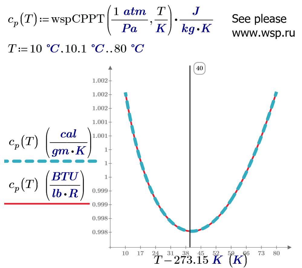

Celsius on a PRIME Plot
ValeryOchkov
How use Celsius here?
Thanks!

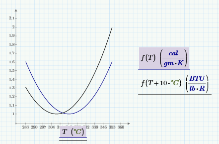

Извини, Валерий,
лучше всего я могу придумать на данный момент.
Stuart
Or (sorry, I didn't bother sorting out the correct equation.

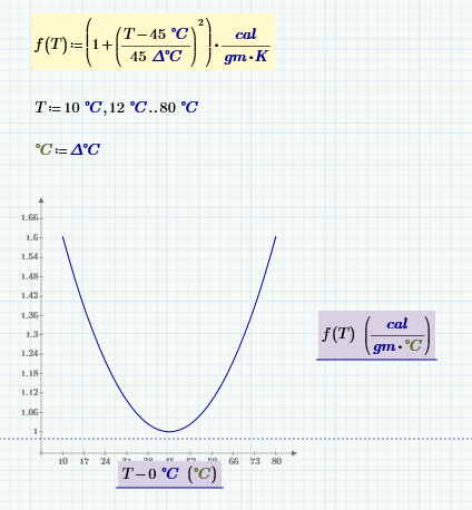

Thanks for that, Fred.  I did try that, but I was so (wrongly) focused on trying to get Celsius in the function units that I didn't think that leaving it as kelvin counted!  Assumptions, assumptions, assumptions, ...
Cheers,
Stuart
