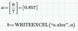

Yes it is possible to use the "round()" function on a matrix of numbers before the writing to excel.
With no round statement.
With the round function.

"So in order to round a large matrix, I have to use some for loops to go through that matrix. "
Yes the round function can be applied to a vector all at once so you loop through the columns of the matrix.

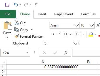

It does only send two decimals to excel.  I formatted excel to show 15 decimal places.
This is how excel shows without formatting straight after transfer.

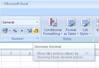

There should be no need to use the ROUND function within excel. You can just set the number of displayed decimals in the number formatting section of excel:

That method doesn't work, since Mathcad is overwriting the cell format in excel.
The round function does work:)
