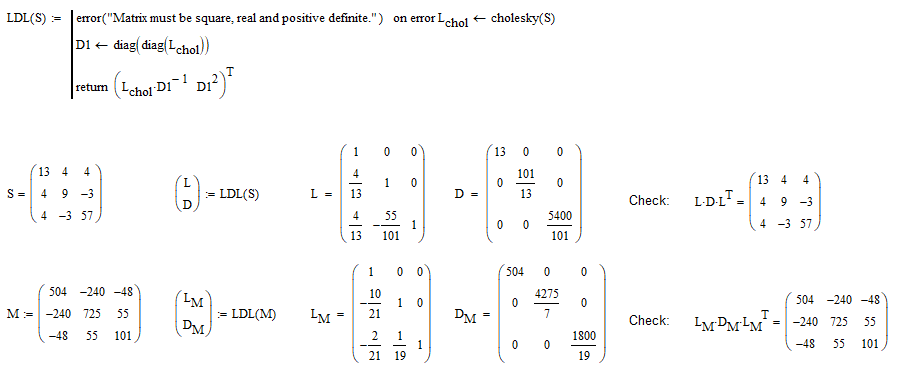

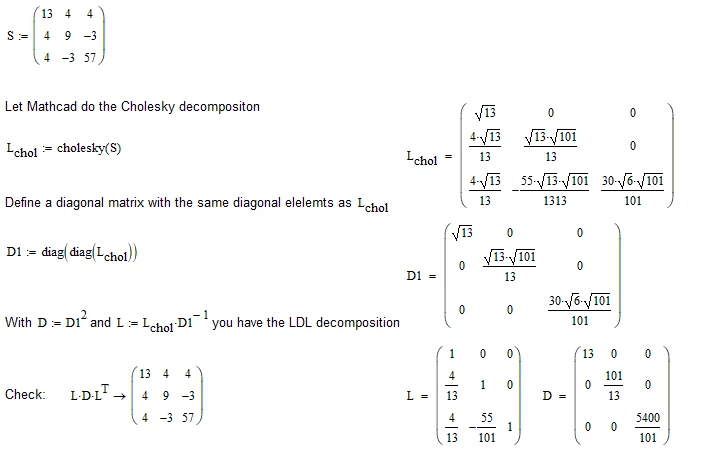

The LDL decomposition is not Cholesky, rather a slight modification of it with the benefit of not having to take the roots.
But its very easy to get the LDL once you already have  the Cholesky decomposition:
You may now define a custom LDL function which does exactly these few steps

(To:JBlackhole)
Thanks a lot for that @Werner_E .
I was looking at pre & post multiplication ! Something like L^-1 A (L*)^-1. but you ends up with a "diagonal" matrix with unit value
If you mean by L the result of the cholesky function, this should  not be surprising. When the decomposition is S=L*L^T, then the only matrix you could squeeze in between using the very same L matrix is the identity matrix I -> S=L*I*L^T.
An additional advantage of the LDL* decomposition over Cholesky is, that it can also be used for indefinite matrices. But the approach I showed will of course not work ib that case because I am using the built-in cholesky() which will only work for positive definite matrices.
A more general LDL() function would have to be implemented in a different way without using cholesky().

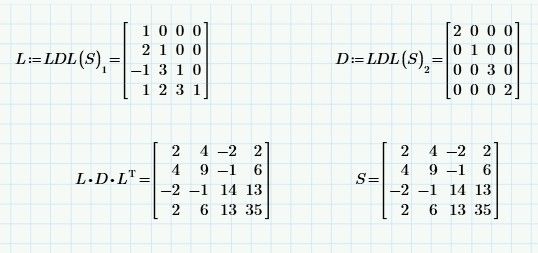

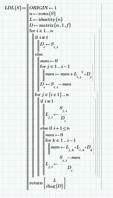

TH_10592087
(To:Werner_E)
Here is the LDL factorization.  If you want to extend this to the solution of Ax=b just ask.
Reference is: https://sites.ualberta.ca/~xzhuang/Math381/Lab5.pdf
Good Luck With It.
Revision to program to correct second summation.
