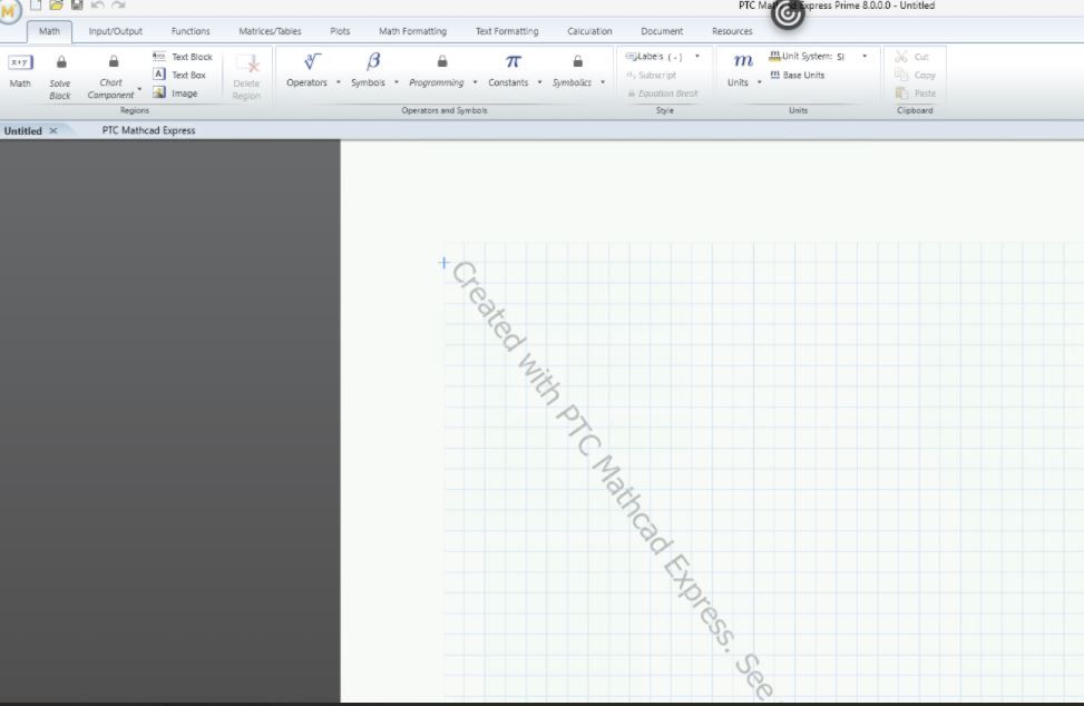

Need link to Mathcad Full installer
AM_10585320
I have an active license, but when i complete the install, my ptc desktop shows a "created with ptc mathcad express:" watermark..  Can you point me to the full installer or is there something i am missing with my install or my current license?
2 REPLIES 2
go to https://www.ptc.com/en/support/mathcad-landing page, click Reconfigure Mathcad button and go through prepared instructions.
