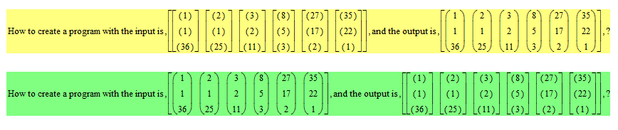

Hi Everyone.
From the following :
How to Clean (and UnClean) ScatterPlot Points ?
Thanks in advance for your time and help.
Best Regards.
Loi.
(To:lvl107)
Here you are!
Hoping not to be followed by "related ..." 😉
EDIT: Replaced worksheet by a version with correct "Clean" function
EDIT 2: Added an alternate version for each of the two functions
You may even have it cleaner than clean 🙂

@Werner_E wrote:
Here you are!
Y..ea...h, with this one, will not be having "related" query, because your answer is very clear, neat and complete to my question.😉😉. Now, I have say: "Thanks, Thanks and Thanks"
