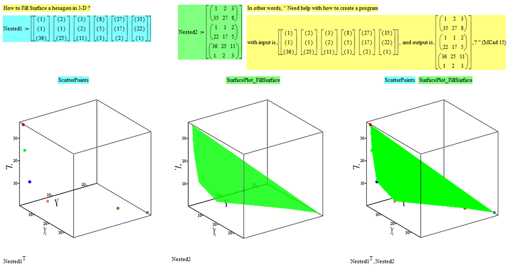

Hello, Everyone.
From the following :
Thanks in advance for your time and help.
Best Regards.
Loi.
(To:Werner_E)

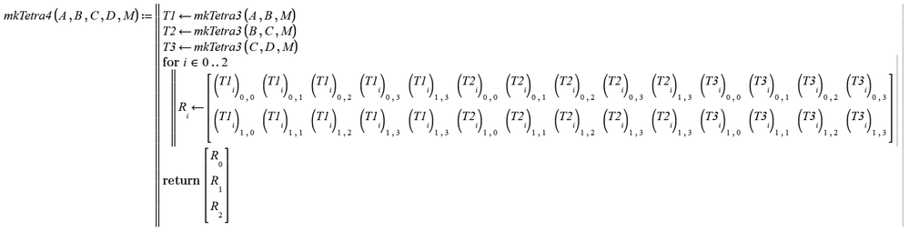

To close this thread (for me), here is a function to implement #4 in my list above. #1 - #3 will be up to you ore somebody else 😉
11 REPLIES 11
(To:lvl107)
The attached should do the job. Works for exactly six points only and the order the points are given is important. So its very specialized and thats the reason I did not made any attempts to make the program ORIGIN independent.

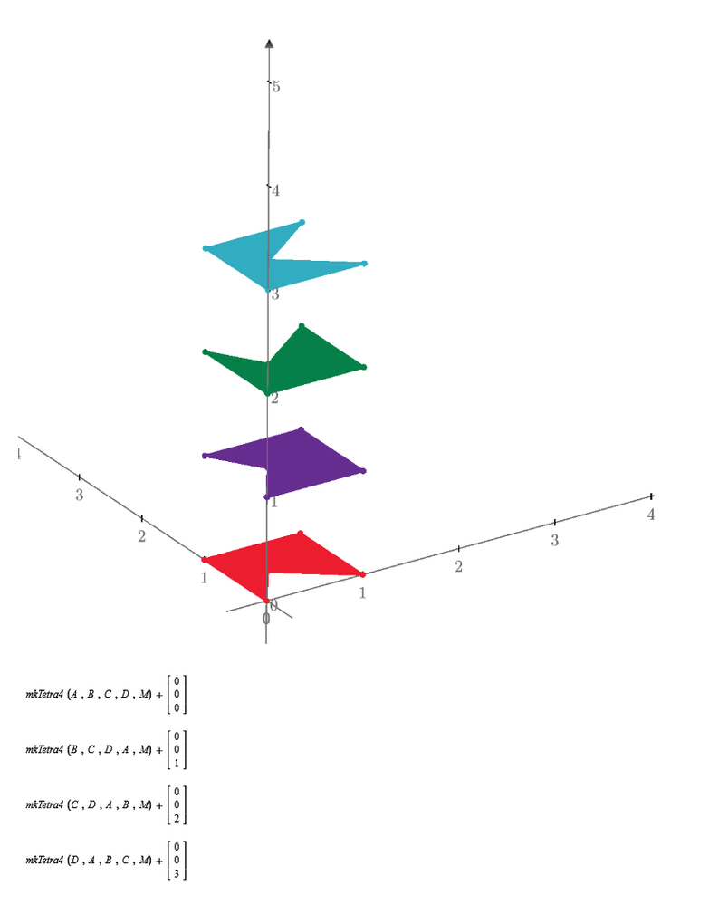

Hi Everyone, again.
From related query as the following :
How to create that program function ?
Best Regards.
Loi.
(To:lvl107)
Like this?
lvl107
20-Turquoise
(To:Werner_E)
Clear and neat answer !, Werner. 🙂🙂🙂

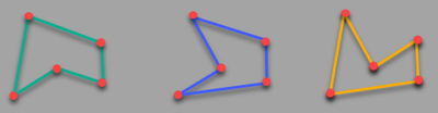

For generalizing the problem:
How to Fill Surface a (convex) Pentagon ?
Best, Best Regards.
Loi.

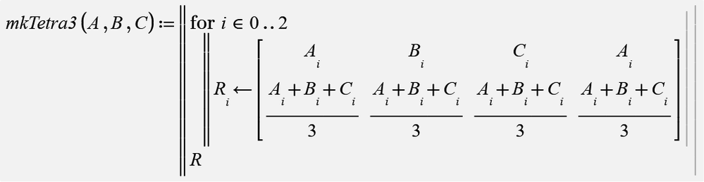

(To:lvl107)
Probably like outlined here: Solved: Re: Rotate a quadrilateral in 3-D ? - PTC Community
But you will have to
1) Check, if all points are in the same plane and at least one is not on the same line as the others - Otherwise: error
2) Check if its possible to form a convex polygon using the given points - Otherwise: error OR you find a decent method how to fill a concave polygon, too.
3) If a convex polygon is possible, you have to find a way to arrange the order of the points so they form the convex polygon in that order
4) Now you can follow with the method outlined in the thread mentioned above, creating for example the structure where all points from #3 to #n-2 are connected with point #1 (last picture in that thread).
Sure a task for some cold winter days ...
(To:Werner_E)
