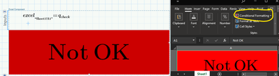

As of Mathcad Prime 9, there's no direct way to do this, but one workaround involves putting the results in an Excel Component as an Input Expression, and use Conditional Formatting there.

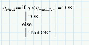

For example: My sheet has "q(allowable)" , and I find "q", how do I make the sheet to give me green if OK and red if Not OK. Please do a step or uplaod a mathcad sheet where you did it. Thank you

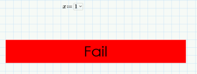

Attached a worksheet!
See if that helps and if you can figure out the rest on your own! I don't know the math behind q and the maximum allowable q so I just defined those as variables (and a combo box for fun), but you can replace those with whatever and it should work.
You can press the - by the Excel Component's input expression to hide it. The magic is that Excel Component input expression being equal, in this case, to qcheck, and if you double-click the Excel Component to open Excel, setting Excel's Conditional Formatting rules to activate upon "OK" or "Not OK" values.

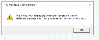

Opps. I have Mathcad Prime 8 and you seem to be using a more recent version so I am not able to open it.
Ah hah... You should upgrade to Mathcad Prime 9!
But here is the same sheet in Prime 8.
I manage the Creo and PTC Mathcad YouTube channels for PTC, as well as all PTC Mathcad marketing in general.
Thank you. But I am still getting the same message . Was this new one made in 8? not sure why it's still not opening when I have 8.

Sorry that my "prime-8" worksheet still tries to open in Prime 9... I thought I had Prime 8 opened while saving it.

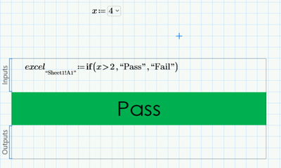

The variable drop-down list is called a Combo Box. Here is a video on how to use it and what it does. You don't need the Combo Box for this problem (since I assume you are calculating q based on some kind of formula or series of calculations), but I thought making one would be convenient for testing the conditional formatting:
https://www.youtube.com/watch?v=GOoVL714Bz8
The only thing I did in Excel was the Conditional Formatting rules for the colours to activate upon "Not OK" or "OK", as well as stretching A1 and increasing the font size.
But the actual result of whether it is OK or Not OK is based on the result of qcheck, and you can see in the Excel Component input expression that Mathcad passes the value of qcheck into A1 of the Excel Component

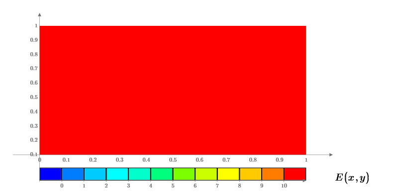

It would be great if you'd add your request to the feature suggestions. This is something I'm desperately hoping for since I do have to check calculation documents of 40+ pages length.
Any result highlighting, aka. conditional formatting, in MC  prime would be welcome.
Without EXCEL Component.
