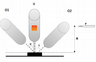

You have a ground fixed punch bag (resting on a spring that's attached to a counterweight).
What is the minimum sensor setup in order to determine:
  • the force of the punch in the bag
  • acceleration of the punch
  • the speed of the punches (for multiple punches)
Notes:
  • no sensor must be attached to the person punching the bag, only on the bag
  • bag is punched in a limited vertical area
Justify the answer with:
  • sensors
  • calculations
Working as hardware engineer, I must admit I'm not that experienced with physics.
I've been trying to figure a way to solve it for a week now. What I thought of is mounting an IMU in the center of the bag and after that gather experimental data by hitting the bag with a pendulum. What's hard for me to determine is the force with which the bag is hit, how much of that force gets absorbed by the padding and the remaining force that drives the bag afterwards. Finding the acceleration and speed of the much would be pretty easy after finding the force, by applying Newton's second law.
Any help would be highly appreciated!
Check attachments section for some visuals on the problem.

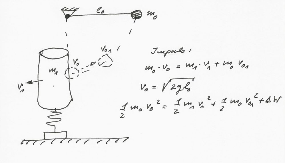

to calculate the forces, accelerations and velocitys, you will have to make some measurements before starting calculations.
Is there any possibility to measure the contact-time?
The punch will be not elastic in the real situation, we will loose energy.
Basically you can start the calculation with this:
Volker

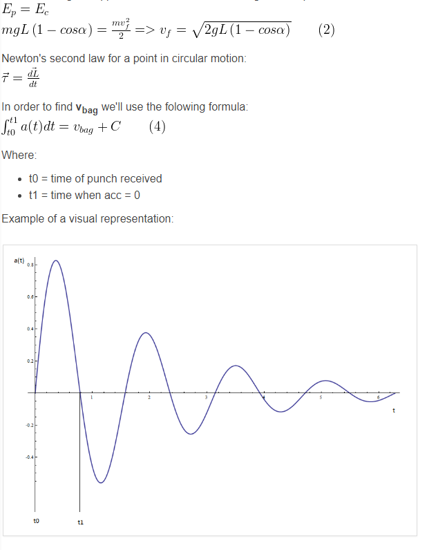

hgpt
(To:vlehner)
You can assume a contact time of 30ms.
Considering the following as known:
There are multiple problems to be solved before taking real world measurements as:
  • where are the IMU's going to be placed and why?
  • how can you accurately measure the force applied by the pendulum
  • what happens when multiple punches are thrown?
I started with the math the same way you did, but got stuck. Here is my progress (after many tries).
I was also thinking at analising the system as a black box and using Matlab System Identification Tool for finding the model, but then I will also need to know the applied force in order to link it to the acceleration of the bag.

vlehner
(To:hgpt)
@hgpt wrote:
Unfortunately, there's not that much info about the spring, apart from:
  • wire diameter - 1 cm
  • length - 20 cm unloaded
Theoretically, it should be solvable based only on IMU data (accelerometer and gyro) and maybe a load cell; this way anything that has to do with the spring gets to be bypassed.
Ok, if you will bypass the spring, you must measure the both velocitys of the punching body (before and after the punch).
You can do this with the elevation hight of the punching body after the puch.
With the difference of these two values for the speed and the delta t, the acceleration/Force would be no problem.
Then the sensor must be calibrated with this values.
I calculated the Punching-Force and acceleration approximately, see attachement please.
EDIT: The velocity of the bag you can calculate with the law of the impulse.
The absorbed Energy Delta W is a measurement for the acting Force (=resistance).
Good luck!
Volker
hgpt
(To:vlehner)
The one thing that I do not understand is why is there a factor of 2x when calculating a_punch  ?
Apart from that, the math seems fine for calibration purposes and testing, but what happens when a real person hits it? There's no recoil of the punch, due to the nature of the impact being plastic.
Further more, imagine someone hits the bag when it is traveling from O1 to O with enough force to stop it, but not enough force to imply a movement back to O1 (the bag practically remains almost still for some time). The equations fail to model this kind of a situation.
There's one more thing mentioned in the problem: the bag is hit in a vertical space. Judging on this, one can say it's not always hit in the center of mass. Imagine this: you hit the bag with the same force:
  • 1st time closer to the base
  • 2nd time closer to the top
The speed of the bag will be different between the 1st and the 2nd hit, while the force is the same.  I guess one more thing that's to be taken into consideration is the torque that's applied relative to the mounting point of the base (the spring). I might be wrong, though.

vlehner
(To:hgpt)
@hgpt wrote:
Everything looks fine, but I don't quite understand one thing: why is there a factor of 2x that is multiplied to obtain a_punch ?
because of the acceleration during Delta t is assumed to be as constant.
