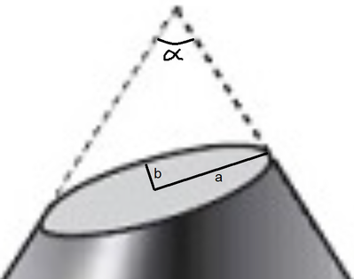

Cone, plane, ellipse
I know a and b of an ellipse. What is the value alpha of a circular cone?

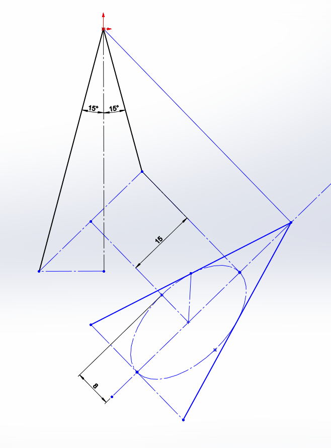

Yes,
here is example when a=15, b=8 and alpha=30 degree...

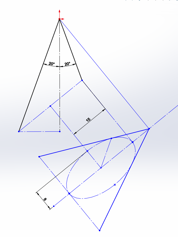

..and when alpha changes to 40 degree
Observe that auxiliary view is normal to cutting plane and does not show real cone angle.

a & b are not sufficient to define alpha.
No mather what alpha you have, you can allways slice cone to obtain ellipse with dimmensions a & b.

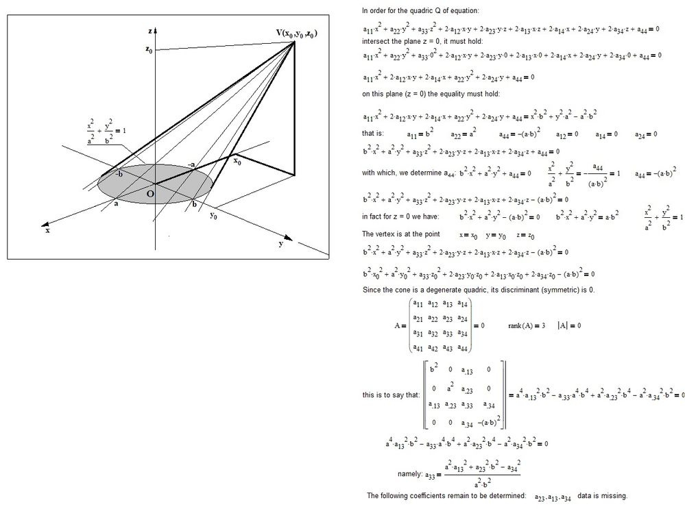

With the use of analytical geometry and with the data available, this is all you can do:
