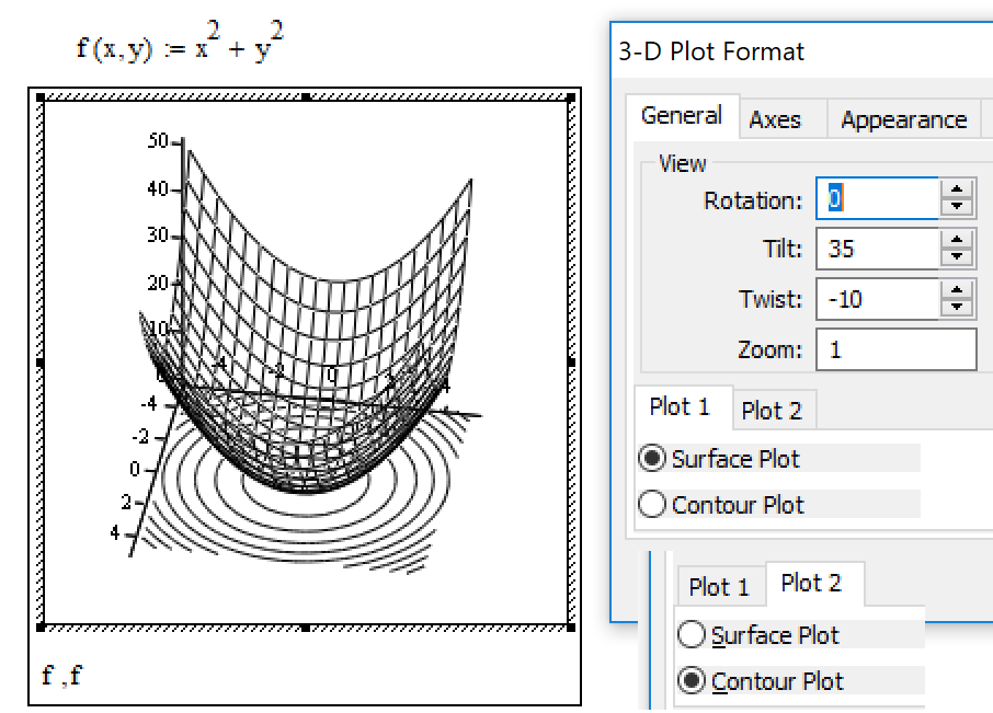

Hi everyone, please how do i add legend to contour and surface (3D) plots with Mathcad 14

What do you mean by a legend? That could mean something that labels each of several surfaces, but that wouldn't make a lot of sense for a contour plot. Or do you mean something that shows what the colors on a surface plot mean numerically?

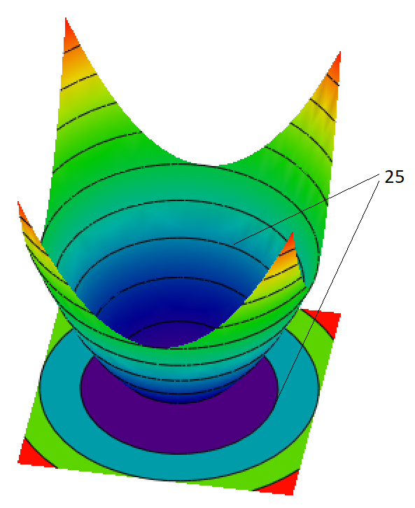

I meant something that shows what the colors on a surface plot represent numerically, likewise for contour plot. Thanks
I have done so for one article - manual with Paint

You create a second surface plot for the legend using the minimum and maximum of your data and hide arguements on second plot.  From an earlier post.  Mathcad and PDF
