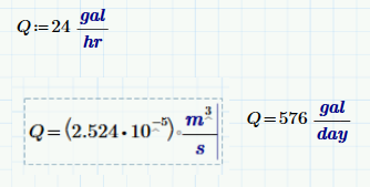

I am trying to have my results in gallons/day but my answer keeps giving me cubic meters/day even though my inputs are in gallons/day
Please help
You change the units by editing to the one's you desire.
In Mathcad 15:units_15.PNGclick on the square place holder
In Prime:units Prime.PNG you delete and replace the units
