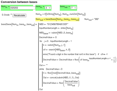

The attached Prime file contains a number of functions to convert radix (between binary, octal, decimal and hexadecimal, or an arbitrary radix in the range 2 to 16).
Some examples are provided.

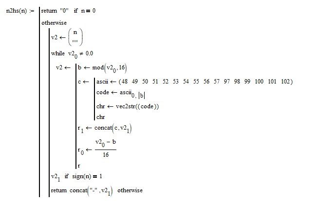

Attached is the file mentioned in the other thread, converted to Prime 6 format so it should open fine with newer Prime versions.
