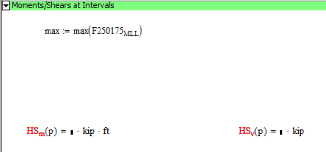

The first one in the area "JBridge - 2 Axel Truck" because Space.2 is not defined
The in "Summary Set-Up", again because the red flagged variables are never defined

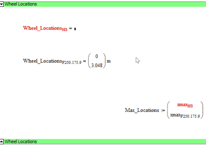

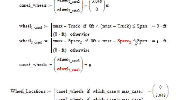

Next errors in "Wheel Locations"
and the last ones here
Again because the used functions are not defined.

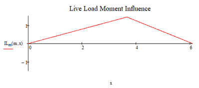

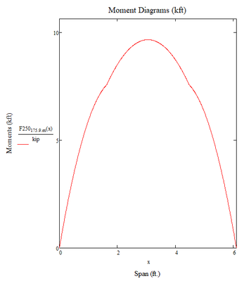

The Mathcad sheet uses a quickplot in the first plot and the values shown are meter because the unit system chosen is SI.
I guess that the plot rather should use feet as base unit.
To do so, you should use (in the Prime sheet) the already defined range p instead of x (not xx), put ft in the unit placeholder on both aaxis and also change the expressions at the axis ends from "Span" to "Span/ft" and from "Span/4" to "Span/(4 ft)".
Of course you first will have to manually change the label of all units to "Unit". To do so you click on every single unit and type Ctrl-U.
The converter did a really bad job by ignoring all non-SI units - really bad.
BTW, to get the first plot done I had chosen a different was by defining
On the left hand side normal variables and on the right hand side units.
This was just a quick hack to get a result but I would strongly advise against doing so. Do manually what the converter should have done and change every single unit in the sheet to label "unit".

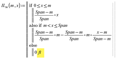

Forgot to also mention that in Prime you have to attach a unit even if the value of a quantity is zero. This was not necessary to do in legacy Mathcad. So you may need to change some functions which normally return a quantity with unit but sometimes simply return zero. You have to manually add an appropriate unit there as the converter, you guessed it, didn't do so.
One example at the top of the sheet:
I have not looked through the sheet but its likely that other functions will have to be treated similarly.
