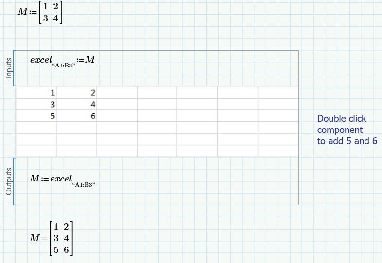

You may also try the Excel component in Prime an see if it fits your needs.
Just tried an experiment.
You can cut and paste from Excel to the Excel component.
Select cells in Excel
Copy Cells
Double click the Excel component in Prime, this opens up Excel.
Paste Cells.
Add your data to the Excel component.
It also works in reverse to copy from Prime to Excel. Don't forget to double click the Excel component to open an instance of Excel.

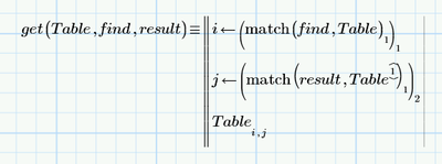

I'm not sure this will help or what region you are in, but I use the latest AISC shape table which is a free download.  I don't want the table as part of my calculation sheets so I keep it as an Excel sheet.  All I do is perform a "ShapeTable := READEXCEL(...)" function and use a more robust lookup function:
This function will ignore blank lines and you can even search for the "find" parameter in any column.  So that way you can have multiple columns of different style of shape names (like HSS2.5 or HSS2-1/2), including SI names, and they don't have to all be on the left hand side of your table.
I can use the full AISC without editing but I usually delete the SI half of the table (except for the SI shape label columns) and add all the appropriate unit labels on the second row.  That way when I import the table, I can apply the units to all the values in one shot.  After that its a simple lookup for anything I need and let Mathcad do all the conversion when I do calcs for Canadian or US projects.
