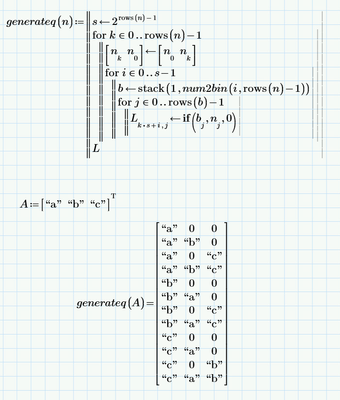

Can only guess that you are looking for something like this:

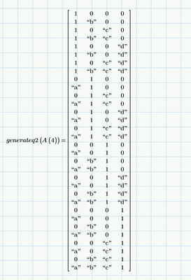

So, don't let what may seem like negative responses discourage you from using the forum; have a go and show what you're trying to achieve.  It might help to walk through how you'd do it with pen and paper, For instance, how you'd use the binary representation of each row number to choose which letter to put where (as in generate), which columns you want the 1 in, what information you have that tells you where any other symbols should go.  A scanned, hand-written note would be fine (please remember to add it you message as an inline photo, you can even paste images directly into the message area).

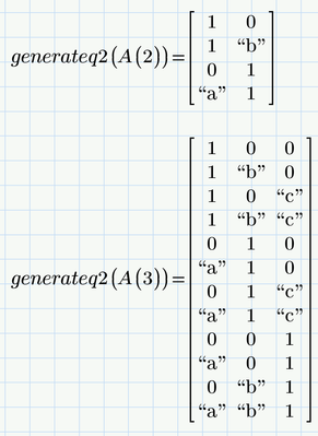

An "obvious" pattern from your example is to replace each leading row element of generate with 1 and then "shift" the leading row over to the jth column.   It might be helpful to break this down into smaller steps by creating a submatrix for each kth subgroup of s permutations.   generate2 shows one method of partitioning L.
There are several ways to stitch the partitioned L back into a single matrix (eg, stacking subsequent partitions onto the first).
