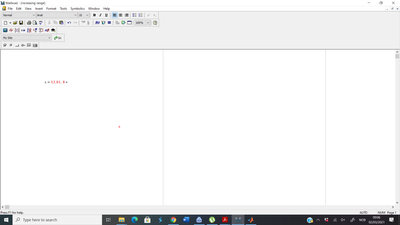

Hi, i would like to have and increasing Range from 3.3 to 8 with an increment of 0.1. When i try 3.3,0.1..8 i will get this range values must defined with sequential values. How can i fix this?
Thanks.

To define a range you set the first value, then the second value (NOT the increment) and then the last value.
So your range definition should look like:
3.3 , 3.4 .. 8
