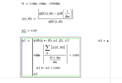

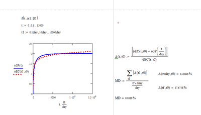

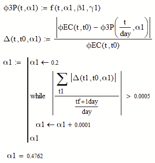

I am looking for an implementation of a program for curve fitting. I have already achieved a good approximation using the genfit function.
Currently, I am trying to improve the fit further by using a routine with while loops that iteratively adjusts the three variables to achieve a better approximation.
However, when I start the loop, it runs indefinitely and fails to find a solution. Could anyone help me resolve this issue?

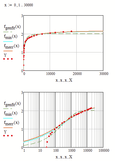

Comparing the three fitting functions it shows (especially in the log-lin plot) that neither provides a good fit for x-values below 100.
For higher values of x, minimize and minerr returned a much better fit compared to genfit.

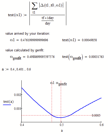

You have to make ajpha1 an additional argument of functions Phi3P and also Delta as otherwise always the same function Phi3P is used, not considering the change in alpha1.
BTW, are you sure that it should read "< 0.0005" in the while condition and not "> 0.005" ?!!
I don't think that you can improve genfits alpha value with your method, which is also very inefficient concerning run time. You should rely on the built-in algorithms an may consider using minimize or a solve block with minerr instead of genfit.

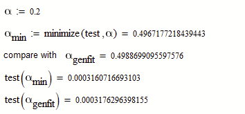

You may test and also plot the cumulated absolute error values
Using this test function you may also use "minimize" to get the best value. It differs a liitle bit from the value derived by genfit and according to the test function its a little bit better.
But this is only a near to optimal value considering that beta and gamma are constant.

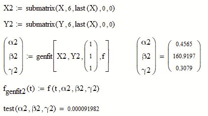

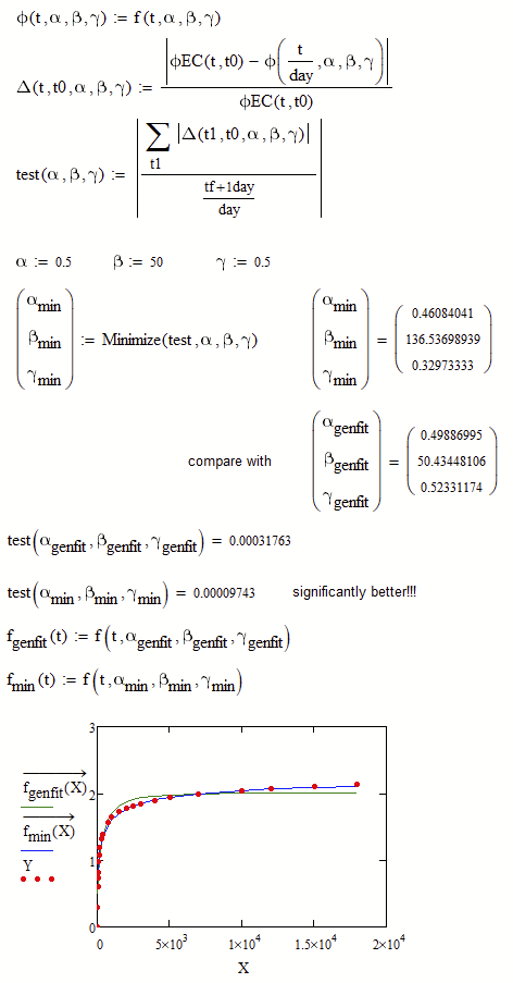

Your fit needs you to jiggle around with all three values at the same time, though.

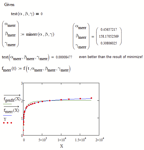

So why not set up the test function dependent on all three and again use minimize:
The result is clearly much better than what genfit could come up with.
While we are at it, we can also try a solve block with minimize
The fit now is even (very slightly) better!

BTW, I found that genfit provides a fit similar to minimize or minerr using your error function, when we omit the first six data entries:

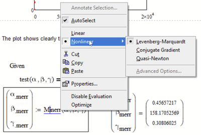

Mathcad by default uses an optimized Levenberg-Marquardt algorithm for genfit, Conjugate Gradient algorithm for minimize and Levenberg-Marquardt for minerr.
You can change the algorithm used when you right-click the keyword genfit, minimize or minerr, but usually the defaults are best choice.
Not every algorithm is available for all functions.

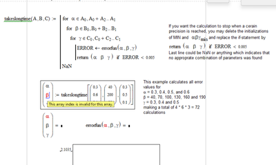

You sure should lookup the syntax for a for-loop in Mathcad in the help!

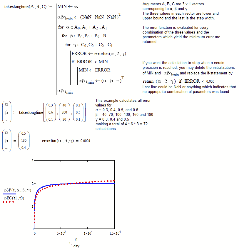

Here is the implementation of the aforementioned brute force method.
Within a given range and step width for each of the three parameters the error function is evaluated for every value of alpha, beta and gamma and the values which yield the minimum are returned.
The method is highly inefficient and sure not recommended.
The example shows very large step widths (0.1, 30 and 0.1) to speed up calculation - only 72 calls to the error function are made..
If you use step widths 0.001, 0.5 and 0.001 instead, slightly less than 20 millions (19 420 821) calls to the error function would be made and this sure would take VERY long and the precision still would be rather unsatisfactory.

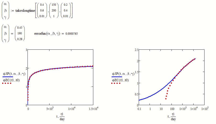

Here are the results of using a finer grid and needs 'just' 22 050 calls to the error function. It already takes a few minutes to finish and while the precision is not very high, the fit already looks much better:

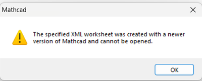

Could you please convert this last one for my version (Mathcad 13.0) ?
(To:MB_12486492)
Damned! Actually I thought I had done so.
Hope it works this time ...

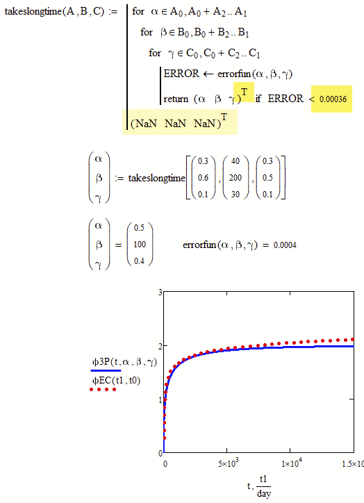

(To:MB_12486492)
Forgot to transpose the return vector.
0.005 is not a very ambitious value. You may try 0.00036.
Lower values return an error which means that no triple was fund which yields a lower error value.
I changed the return value in this case from a simple NaN to a 3x1 vector of NaNs.
You may try to decrease the step widths then - of course at the cost of calculation time.
IMHO the Monte Carlo approach gave surprising good results within reasonable calc time - so for a brute force attack (as opposed to using a more sophisticated Newton like algorithm) I would vote for it.
