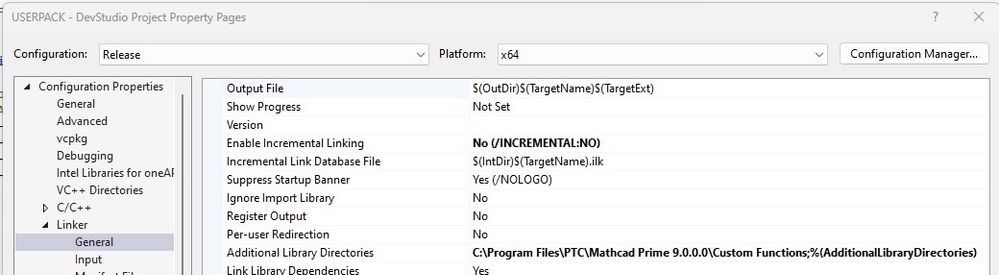

Have tried all I know (which is little) for a couple of days now.
 Could someone explain all the steps including how to set up the Visual C++ Community IDE steps to get the provided multiply() custom function to work in Prime 9?

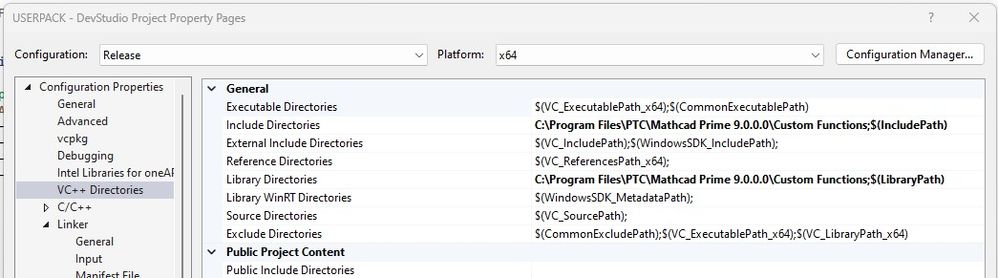

Thank you for the information provided. Followed the instructions:  Set the lib file and current Prime 9 directories.
Compiles successfully and have tried the name as compiled and just userpack.dll
Nothing:
Can someone supply me a working dll for say multiply.dll to see if my install of Prime 9.0.0 is suspect.

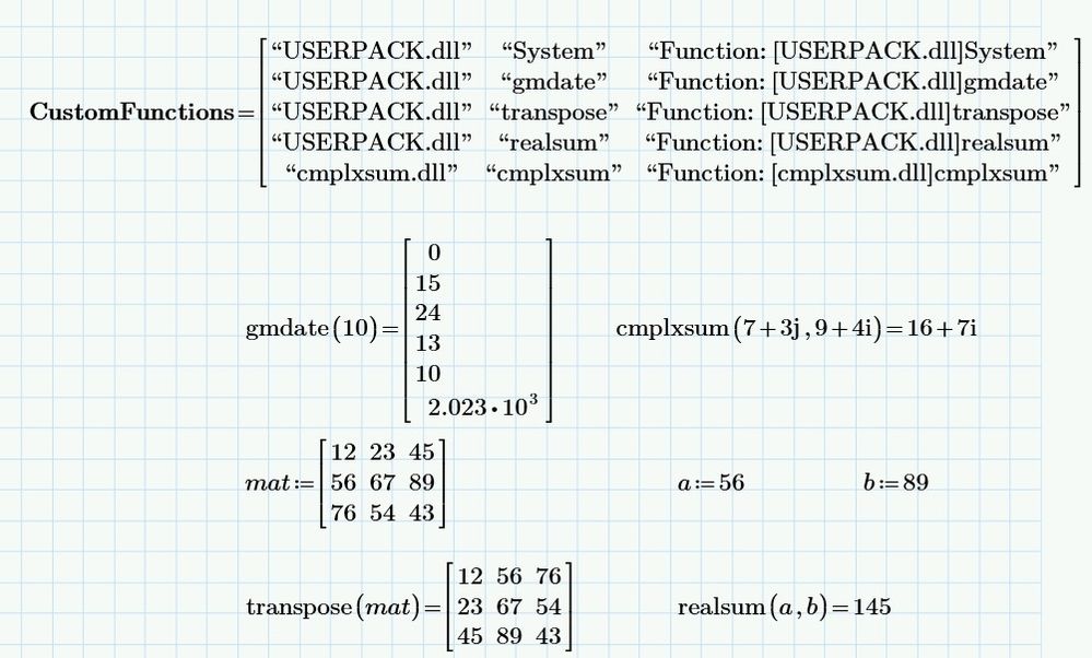

Thanks Luc.  Yes restarted Prime, have even tried whole computer restart, nothing in the CustomFunctions() nothing works.
Hi
After three days persistence pays off Thanks for the help.
