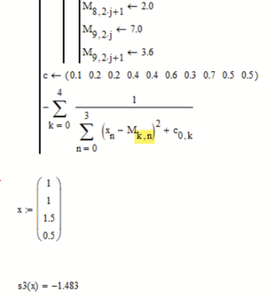

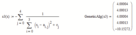

Hello everyone,
In the attached worksheet, I would like to define the Shekel family of functions using Mathcad.
I am stuck here. I can’t find the error, help me.
I appreciate it if you share your idea and advice on this worksheet.

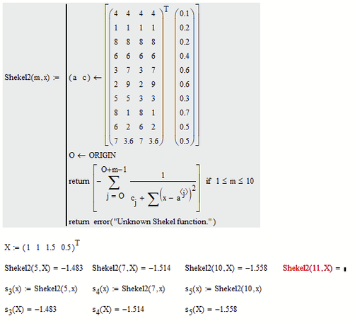

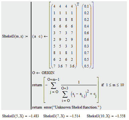

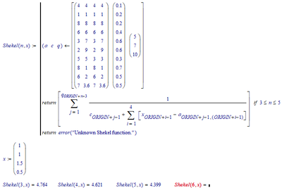

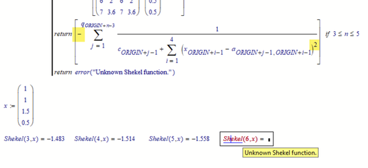

Even though your function is a bit cumbersome, it is easy to repair. You have overlooked that in the text the first index of a_i, j denotes the column and not the row. This can be easily repaired, either by transposing the matrix M or by swapping the two indices in the formula (as can be seen in the picture).
It also would be easier to define c transposed, this way you can avoid the index 0 at c.
As you have seen by the answers of Fred and Luc, its more clear and elegant to define the matrix as an array.
Luc also provided a single function for all three Shekel functions which is also ORIGIN-aware.
His result differs because he missed the leading minus sign and forgot to square the summands:
Fred used Primes table feature (not available in real Mathcad) to build the matrix. Note that he had set the system variable ORIGIN to 1 and also transposed the matrix a, so he could use the very same indices as in the text. His result is different because he mistakenly included the c_j in the sum.

Here is a slight modification of Lucs implementation
Or, to be even closer to the notation of the formula in the text

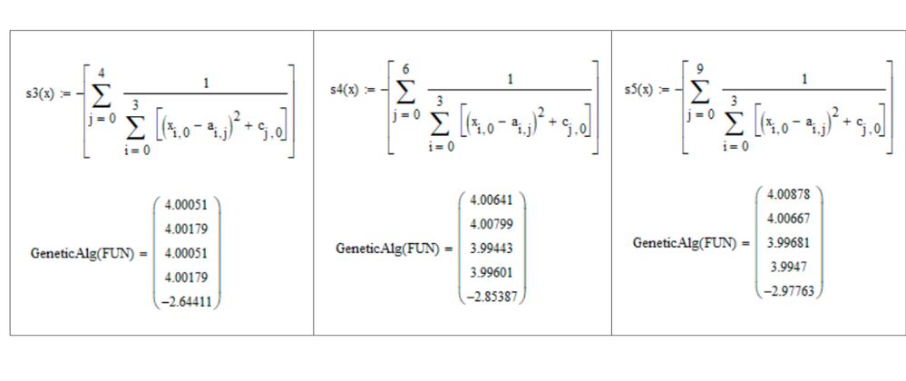

Thanks Fred, Luc and Wernner for your advice and good answers.
I applied a genetic algorithm to the shekel functions given by Fred to find the global optimum and it gives me values of the four parameters x1, x2, x3, x4 approximate to the answer indicated in the book of Zbigniew Michalewicz; that is 4, 4, 4, 4. But the value of the functions are not equal to s3min = -10.15320, s4min = -10.402820 y s5min = -10.53628; otherwise they give me values like the ones shown in the attached image.
Do you have any ideas to fix this problem?
Big thank.
Carlos Romero.

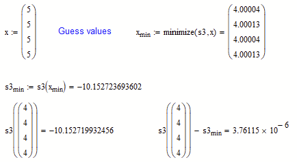

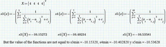

If I correct the mistake that Werner pointed out, then put in the answer indicated in the book of Zbigniew Michalewicz; that is 4, 4, 4, 4 we get very close:

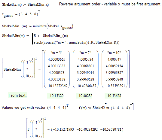

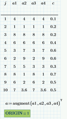

I guess thats the picture Fred intended to attach
Actually your genetic algorithm quite often results in less useful values (obviously because of the random values created) quite often when you recalculate the expression.
The values shown in the first pic belong to a minimum which is even a little bit below of what you get with a vector consisting of all 4's.
Its also unsure how the text arrives at the value -10.15320, Maybe the values in the matrix a are not exactly 3.6, etc. ?
As you can see in the picture below, Mathcads built-in "minimize" command arrives at the same values as your genetic algorithm (if the latter choses "good" random numbers).
Remark: minimize is also very sensitive with respect to the guess values and with different guess values you might only arrive at a local minimum and not the global one.

Thanks Warner. That´s correct.
I see a function with the same name and a different number of parameters.
Can you please explain this to understand how Mathcad "thinks"...?

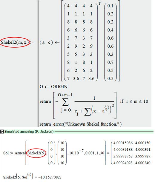

If you define a function like
f(x,y):=x^y
then f(3) is somewhat equivalent to g, where g(y):=f(3,y) (which is equivalent to g(y)=3^y).
This means that if we don't give all arguments in a multiargument function, we create a function in the remaining arguments.
Instead of writing "Shekel2(5)" as argument in the "Anneal" function, I could have defined a new function "sh(x):=Shekel2(5,x)" and use the function name "sh" as first argument in "Anneal".
Mathcad is not fully consequent and something like Shekel(5) can't be used in all situations like a simple function name. For example we cannot write something like Shekel(5)(3)=

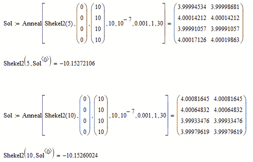

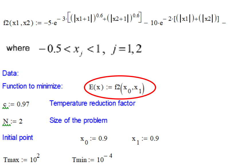

Thanks Werner for your experience and very good observation Luc on using multiple arguments of a function in Prime.
I want to check the operation of a simulated annealing algorithm with the shekel functions. The example function for this algorithm has two arguments.
How would you apply the trick in the shekel function to use this algorithm?
Thank you.

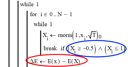

I am not sure what exactly you are looking for and the worksheet does not match the picture you posted.
See if the attached file helps.
I haven't looked at the algorithm you implemented, but it doesn't seem to find the minimum.

Maybe for some functions works. Here an example. It takes 5 minutes.

Hello Werner.
Thanks for sharing your experience in Mathcad.
The algorithm works but it is also very sensitive with respect to the guess values.
