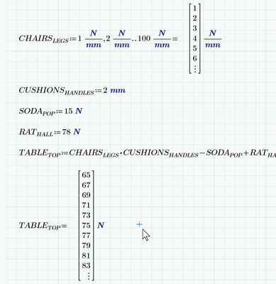

You must be aware of the difference between a range and a vector.
Range variables should be used only for
1) indexing a matrix or vector
2) specifying the range of abscissa values in a 2D-plot
3) a for-loop in a program
In all other cases you should use vectors for a list of values.
There is an undocumented trick which quickly turns a range into a vector via inline evaluation which I used in the picture below. Doing calculations with vectors can be tricky and to be on the safe side you should use vectorization (I didn't in the screenshot below) to avoid unwanted effects.

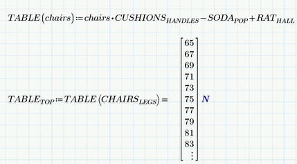

A much better way IMHO would be to set up functions. In your example TABLE could be defined as a function if CHAIR (or maybe with all the other variables as function arguments, too) and could then be called with the vector as function argument. Here I used vectorization:

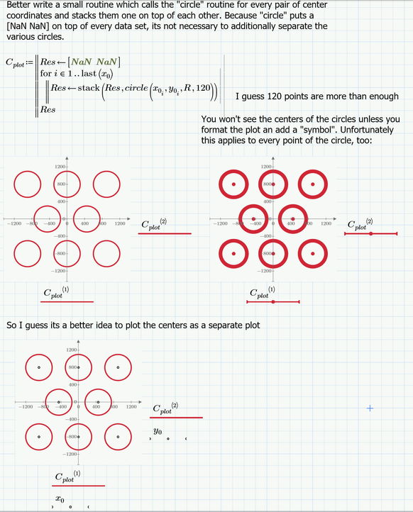

Prime complains that the index j to xo must be an integer. It apparently isn't coupled to your definition of j as a range.
Check your labels. The defined j is labelled as a 'variable', the index j (to x0 and y0) is a default '-'.

Something like the attached?

The attached sheet should help.

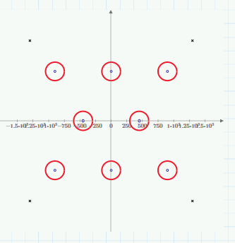

Dear Mr. Werner_E and all  , Can we convert this equation circle to rectangular array as picture above?
Can you help explain me please? thank you in advance.
