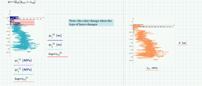

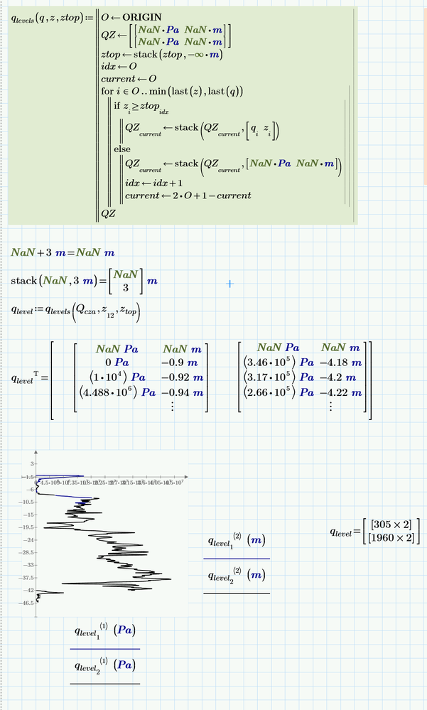

Last time we wrote this function to classify soil layers. I need to show that in the plot can that be possible in mathcad ?. I need to connect the table with the plot . so it draws horizontal marker whenever the layer changes. or change colors ..any kind of change to make it possible for the reader to understand it changes layer type
Like (y ) will be both z and ztop to draw the plot .
z is the depth
ztop the thickness of the layers
(To:Werner_E)

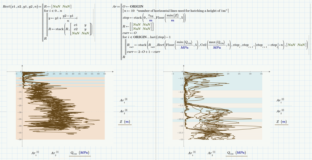

Not sure but cold it be that you are looking for something like this
It would also be possible to color the various section according to their depth, but this would mean that we have to split both vectors i  various subvectors and use them in the plot, which also means that you have a lot of entries (8) at both axis and would need to manually add or remove entries it the number of z.top values changes.
Prime 10 file attached

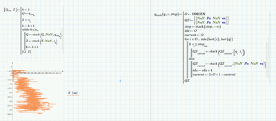

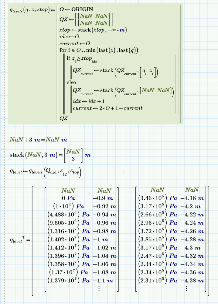

Dear Werner,
Is it possible to merge these to programs together. I need to show the levels in the plot in the left , I couldn't do that because it shows error . instead of using only q12 I need to use The Qcza which contains all of the qcza...
I previously used z12 because it is the longest. So it is okay to use Qcza and z 12 not Z
I also have a mistake , I couldn't include the unit of the infinity
Unfortuantely, I couldn't open the sheet you sent because it is higher version than mine. I use prime 9
Thanks in advance

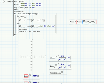

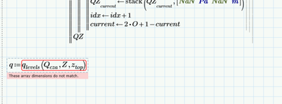

see it shows mistake even when I use q12 .. is the version the reason ?

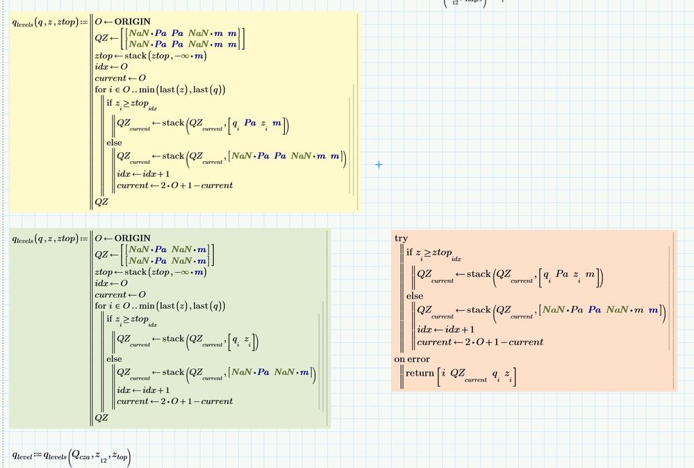

I don't think so.  The error likely arises because you are trying to stack a 2-column array ([qi zi]) onto a 4-column array (QZ).   Is there a reason you have a separate column for Pa and M?  Guessing that you only meant to have the q and z columns (from the stack(q[i, z[i) expression that gave the error), I removed the Pa and m columns, and the function seems to work OK with z12 - see function with green highlight.
Stuart
Quick Tip 1: If you're hitting problems with "dimensions", step back and think about which "dimension" Mathcad is referring to in any particular case - quantities or arrays!
Quick Tip 2: If you're getting a problem that's making you pull your hair out, try "try" to catch the error(s) and return the values of interest.  I've often picked up errors by that way.  You can see that I'd added the extra Pa and m columns to the expression stack(q[i, z[i).

And I wrote the same program like yours ( in green highlighted box) and still didn't work .

@YA_10963798 wrote:
Stuart,
Where to find (try function) sorry for the stupid question;)
(Edited to add screenshot)
It's not quite the same.  You've still got the extra Pa and m columns in the initial value of QZ, ie you've got 4 columns instead of the 2 to match stack(q[i,z[i).
It might be less visually confusing if you remove the units from the NaN.  (Just checked, and it turns out units aren't necessary with NaNs, Mathcad seemingly being smart enough to treat them as having a universal unit.

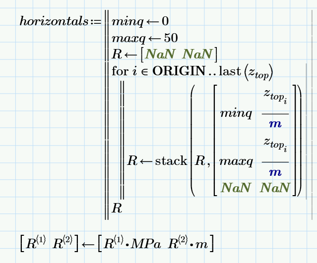

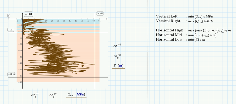

horizontals are undefined here, how did Werner make them defined and showed them in the plot in his answer

@YA_10963798 wrote:
yes , you are right thank u
last question;
Did you use the horizontals program that Werner used?
Werner's program is dimensionless and assumes that you've entered MPa for the qlevel columns.  If you want, you could add the extra expression I've shown to the program, placing it just before the final R.  You could leave the x-axis units as Pa or change them all to MPa; (the depth is in metres anyway, so no change needed).
Stuart

@StuartBruff wrote:
@YA_10963798 wrote:
Stuart,
It's not quite the same.  You've still got the extra Pa and m columns in the initial value of QZ, ie you've got 4 columns instead of the 2 to match stack(qi,zi).
Forget what I said about removing units.  Mathcad's not quite as smart as I thought it was when it comes to using mixed units in an array.
Here's the (re)corrected qlevels function.
When plotting the Yellow qlevels function result, use column 3 not column 2 for depth - column 2 is just NaNs.  You get the same result as shown above when using the correct columns.
Because there is that discontinuity in the plot, I sighed manfully, opened Werner's worksheet, copied his splitIn2 function and renamed it to qlevels ... and happily (for me, anyway) got the same result.  He also just uses the 2 columns.
Stuart

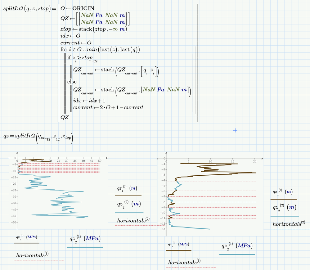

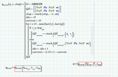

YA_10963798
(To:StuartBruff)
and when I use the yellow highlighted box I get this
StuartBruff
(To:YA_10963798)
The unit-corrected Green qlevels function I posted works, but if you want to use the Yellow version, then the depth data is in column 3, not column 2. Yellow column 2 is full of NaNs.
(To:YA_10963798)
Better always state the version of Prime you are using.
I guess the errors you made were already corrected by Stuart.
You misinterpreted the 1x2 matrix with the units as a 1 x 4 matrix. I used the implicit unit multiplication (Ctrlk-Shif-U) and not an explicit multiplication sign between NaN and the units.
You missed the unit meter for the infinity "value".
But it still does not make much sense to use the full combined vector Q.cza as first argument and the vector z[12 as the second one, as only a small part of the plot would show.
You would have to use the combined vector Z as second argument, but probably my program would fail because it assumes the values in the second argument to be sorted by size. So it would be needed to change the function splitIn2 to cope with a vector z where sorted vectors are stacked and separated by NaN's.
Instead if doing so, I wrote a separate function splitAll which you can call with q.cza and z which loops through the vectors,uses the original splitIn2 function and stacks the 14 results one on top of the other:
Prime 9 file attached

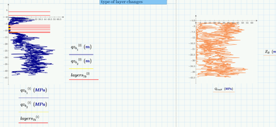

Can you tell me where is my mistake ..
When I wrote it for the first part (7A) I got the same plot
When I tried it with the second part 7B I couldn't figure out where I mistaken to get different plots
(To:YA_10963798)

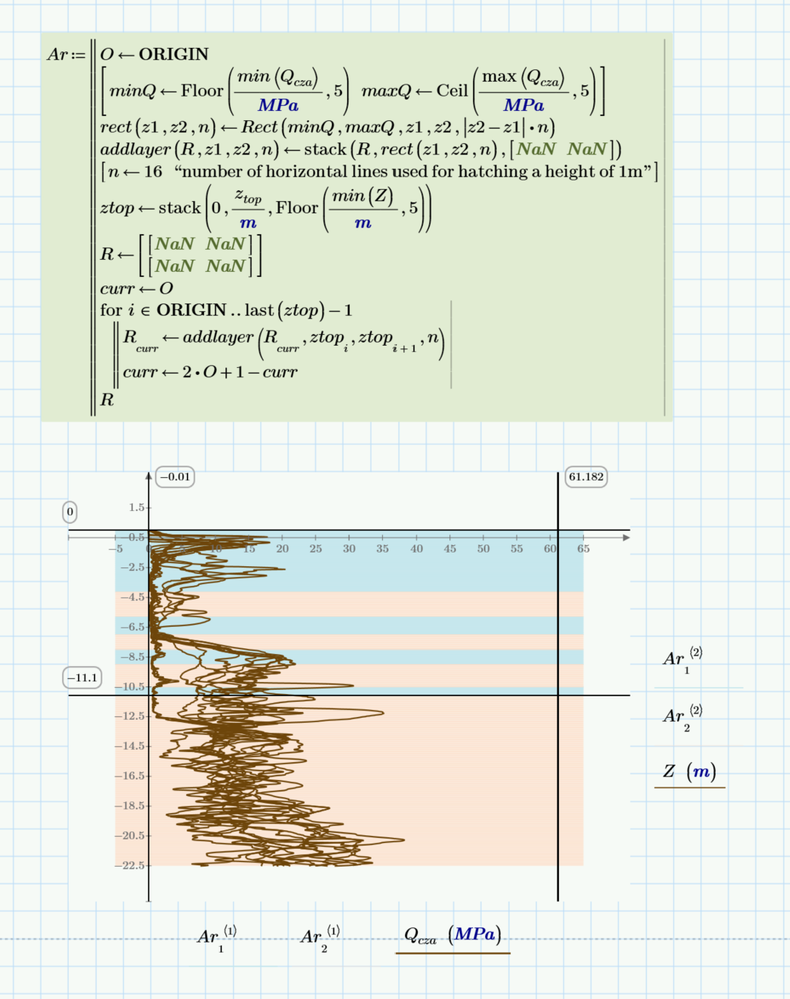

Thought it could be nice to indicate the various depths that way
Of course you can combine this with the other two ways, drawing horizontal lines and drawing the traces in different colors.
Prime 9 sheet attached

StuartBruff
(To:Werner_E)
Terribly sorry about this, Werner, but I just couldn't help it ...
I'm embarrassed to admit that I have a fetish for functions and strongly believe in local functions for local programs, So I felt compelled to modify your Ar program.
It's a matter of swings and roundabouts as to which form is more readable and understandable with such a short program. However, even with brief program fragments, I usually find it helpful to use local functions to hide the nitty-gritty and show the essentials of what's happening.  In this case, because the value of Qcza is independent of the i loop and ztopi and ztopi+1 are used twice, the Rect function was too tempting to leave alone; hence, the local function rect appeared.  The rest of the program line simply called for it to be wrapped in the descriptively named addlayer.  Then min and max Qcza complained about calculating the same value every time, so they had to be whisked out into minQ and maxQ.
I added horizontal and vertical markers to the plot (As you suggested, but before I read your suggestion.  One day, I will learn to read things before diving in like a mad bull on a sugar high in a china shop.  It will save me a lot of time.).  The markers have appropriate expressions in their numerical placeholders rather than having fixed values.
It took me some time to spot that you'd changed the min Z to 35 m.  I spent that time wondering why your plot looked different to mine after I'd edited the Ar program!
I changed n to 16 because the gaps between lines were a bit too obvious on my screen (possibly because my Dell has a 3840x2160 display).
Alas, a compulsive's work is never done.
And I wonder where the day goes ... 😀

(To:StuartBruff)
No need to be sorry or embarrassed.
I am aware that my Ar (had "Areas" in mind, I guess) is just a quick hack and would hardly win a prize for elegance and beauty 😉
Normally I think I would have provided a function with arguments x - and y-vectors of vectors and the z.top vector. But I didn't take the trouble to embellish the thing after the first successful test attempt.
Meaningful local functions and variables sure enhance readability a lot.
As for the horizontal lines I mentioned I had not in mind the plot's markers but rather the "horizontal" (or later "hor") data structure which was my first answer to the desire to visualize the different layers.
Prime's markers can't be automated that way, at least not concerning their numbers depending on the number of elements in z.top.
Changing the axis min/max values was a just fast way to achieve a zoom option - actually its the only way to do it in Prime as we don't have the visual zoom-option using the mouse as we had in Mathcad.
BTW, I use a 4K display, too, but on a 15,6" notebook screen. Still I noticed that the individual lines are visual in the zoomed in display but I did not care 😉 I thought that omitting the lines with the NaN's which separate the individual lines would make it significantly denser but that was not the case. We could remove them nonetheless in case of simple rectangles.

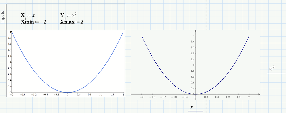

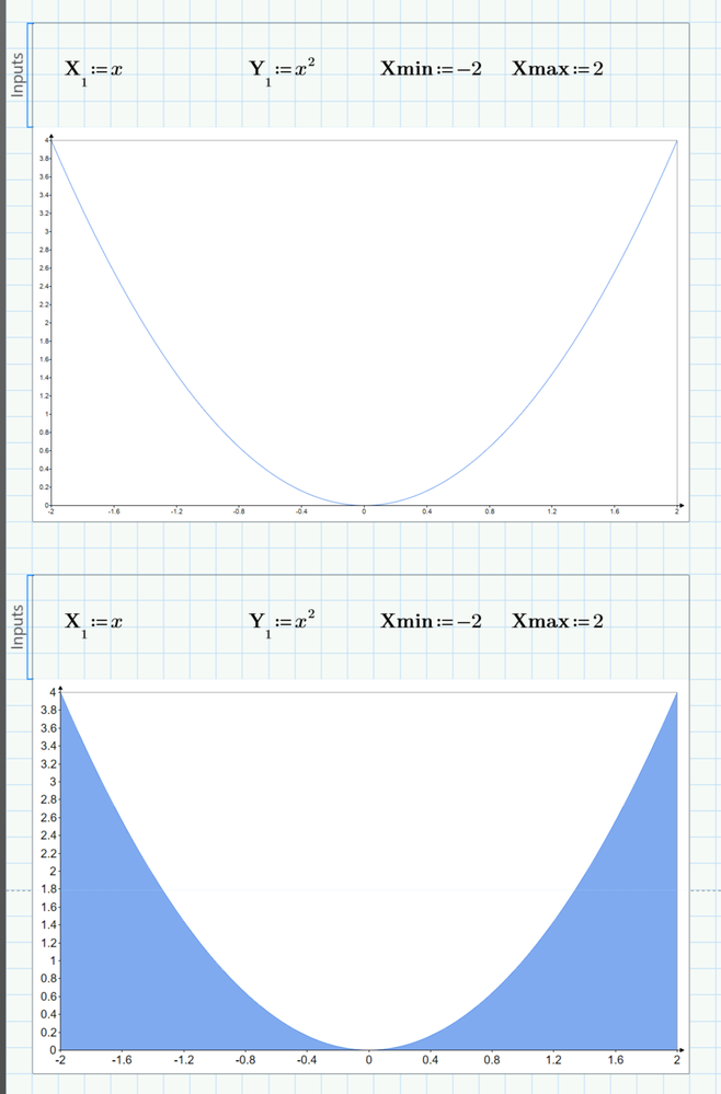

A long-standing feature request, that probably resides in a PTC File 13 folder somewhere, is the ability to save an plot image to a matrix for further processing or documentation.  You can at least save a Chart plot as a png, although I'd prefer to do it from a right-click context menu rather than having to open up the Chart Application.
Also, given Richard's comments, if it's not already used for the Plot component, I wonder why it isn't.  It seems more capable and has a 2nd Y-axis - very useful.
Chart XY Plot
Plotting large data sets in chart components can affect performance.
To help you minimize this effect, the following limitations are built-in:
The maximum number of traces is 50 per chart component
The maximum number of plotted data points is 2,000,000 per trace
Charts that have at least one trace with more than 50,000 points lose their selection layer in the chart application
Additionally, when plotting large numbers of symbols, you can benefit from using the following Symbols settings:
Shape: Square
Thickness: Thinnest option
Weight: 1 px
Opacity: 100%
Using an XY plot, PTC Mathcad can plot up to two million data points.
n points vs capability:
0 – 4999
All trace formatting options are fully available.
Each symbol represents a single data point.
5000 – 49999
Trace Color and Trace Thickness: Full availability.
Symbol and Line Style: Limited availability.
Each pixel represents one or more overlapping data points.
50000 – 2000000
You can only select the Trace Color.
Stuart
(*) I think I ran my first version of Mathcad on the Amstrad.  Then again, I've bought and built so many computers over the years, it could have been anything of that era.
(To:StuartBruff)
According using the third party tool for the native plots, I guess if PTC's programmers would have been able to do so, they woiuld have done. Instead we have an "integration" like the one we experience now.
According the native plots, I vaguely remember that some PTC guy posted that improvement of the native plots still is on the todo list of PTC. Not sure if that meant the 3D plots (which really would need a lot of improvement) or the 2D plots as well.
Another problem I experienced when I implemented the last layer-identification approach with the hatched background was, how to define the order the traces are plotted (the filled rectangle must be plotted first, of course).
In Mathcad it was clear (while not really convenient if you wanted to add a plot which should be plotted before all others) - the order the expressions were placed was the order the traces were plotted.
In Prime it looks like its the order in which the traces were defined. So if you create a new plot and place it in front of another, the new one is still plotted last. I like in Prime that we can rearrange plots, add plots before or after an existing one  and the existing one will still hold the color and other properties it was assigned. But I think an option to have control over the order the traces were processed by the graphics engine would be a welcome tool.
