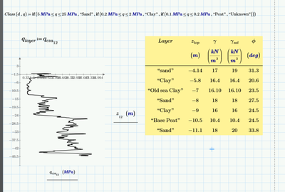

Last time we wrote this function to classify soil layers. I need to show that in the plot can that be possible in mathcad ?. I need to connect the table with the plot . so it draws horizontal marker whenever the layer changes. or change colors ..any kind of change to make it possible for the reader to understand it changes layer type
Like (y ) will be both z and ztop to draw the plot .
z is the depth
ztop the thickness of the layers

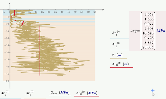

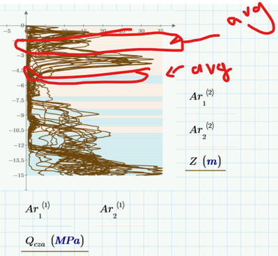

I was wondering if it is possible to get the average value of Qcza in each layer....actually what makes it hard is that each layer(Ar) has many qcza and each qcza has many values in the same layer.

Something like this?
Prime 9 sheet attached

Yes thank you.
This is the average of all qcz in each layer, right?
(To:YA_10963798)
@YA_10963798 wrote:
Yes thank you.
Yes.
If I made no mistake, the program loops through all vectors in z, determines the layer number and sums up the corresponding values in the corresponding qca vector.
On optical inspection in the plot the averages look a little bit to low but this may be 'cause the lower values of the qca plots are more one over each other and so create the impression that there aren't that many.
To be on the safe side you may 'manually' (of course with the help of prime) check the one or the other layer.
