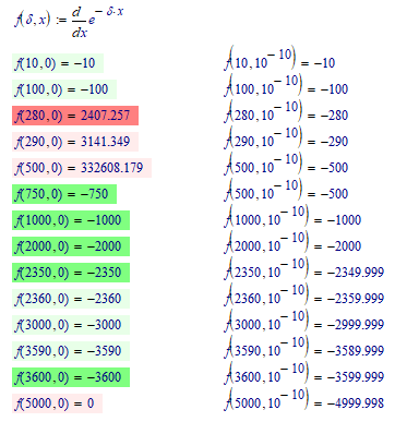

I really don't understand why when using a Symbolic Calculation, the value is obtained more accurately than when checking the value normally. What should I do so that the derivative is calculated correctly?
18-Opal
March 28, 2022
Looks like a bug! Seems to diverge after delta = 287
ttokoro
March 28, 2022
I think its a bug. Use next Tip.
t.t.

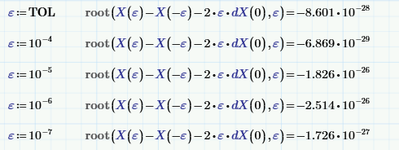

And this is clearly a bug, because the answer should be -1000 exactly. Assuming that the numeric derivatie would be calculated with:
Setting a reasonable value of epsilon, like TOL, gives:
That's closer, but not good. Try:
Hmm:
Now we're getting somewhere.
We can try to find the value of epsilon that Prime would use, if my assumption is correct, with:
Working that around, and using the root function gives, for various guess values of epsilon:
OK, let's try:
Apparently Prime uses a different, buggier method to numerically find the derivative.

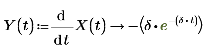

So, in case of numerical derivatives, you should better define the derivative yourself, using the symbolics:
Or you can check the numerical derivative with:
Which gives:
for your example.

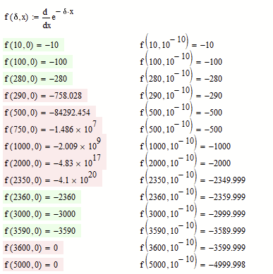

Not only Prime, the problem already exists in real Mathcad. Here is a screenshot from MC15
Also interesting and confusing that for values between 2350 and 3600 the algorithm returns the correct result just to fall back to 0 for larger values of delta.

March 30, 2022
Mathcad 11:
or, directly:
According to the manual, Mathcad 11 uses the Modified Ridder's method (Press et al., 1992; Lorczak). Then appendix L reveals that Press et al. refers to 'Numerical recipies', and Lorczak refers to 'The Mathcad Treasury'.
They must have broken something between Mathcad 11 and 15...
Ah, and your sheet:
And of course you have this variant. Note the red star!
